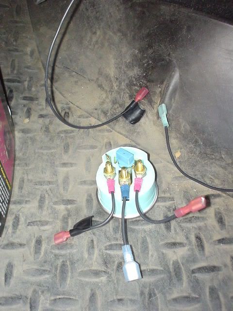

42RLE + B & M Transmission Temperature Gauge
If you've been following this thread, you'll like this new 42RLE addition
Cost: $54 for B&M kit shipped from Summit Racing, and who knows...~$60 + 5-7 gallons of gas making 3 cussing trips to the hardware/auto parts store.

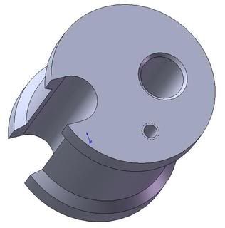

Concept temp sensor clamp:

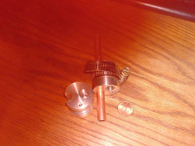

Made with lathe & mill:

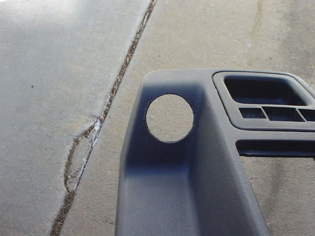

Drilled a 2-1/16 hole with a hole saw (trip #1 & #2, ~$60 @ hw store):

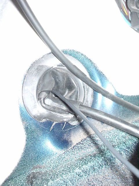

Sensor wire follows the shift cable out and down the firewall:
Sensor is threaded into the aluminum 'heat sink' & held on by a stainless clamp:
^^its attached to the drivers side line - the hot side.

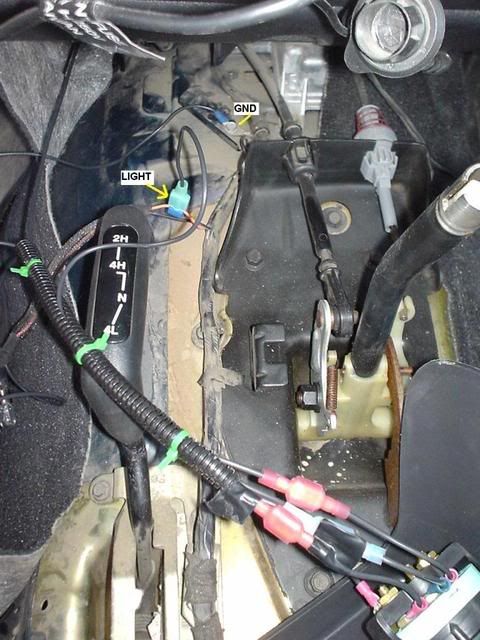

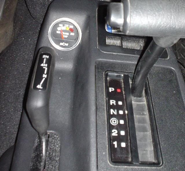

I put three short pigtails on the gauge wiring so the console can be easily removed, wires are color coded & marked (trip #3, $12 @ auto parts store):
Now the cool part -
The console has a little light that illuminates the shift locations, and this light dims with the dash. I spliced into the orange wire and hooked it to the backlight on the gauge - this means it lights up with the dash, and dims with the dash. Also there is already a ground for the subwoofer, so I reused the factory screw/ground location.
It works!!
160*F after idling for 10 minutes - 210*F coolant temp-
Special thanks to "dbbd1" for giving me the idea for the concept, and sending me a bunch of heat transfer compound, which I packed around the sensor to hopefully make a better heatsink between the aluminum and the brass of the sensor. An easy alternative would be to fill the hole with ATF+4 or air compressor oil or mineral oil and then thread the sensor in before mounting.

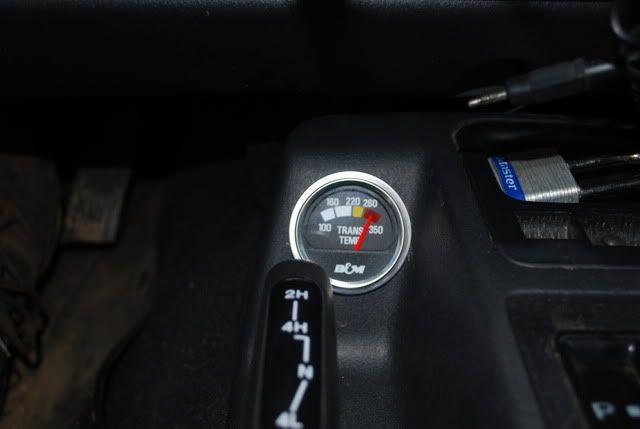

well, went wheeling & snow bashing...trans was around 130-170*F most of the time...then all the sudden:
Put it in Neutral and let it idle. Crawled under there...definitely not 360*F. Sensor was covered in muddy water, which tells me its grounding out through the water somehow. Looks like I definitely need to shrink wrap it or something.
EDIT: I have since fixed this issue by placing a 1/8" thick little piece of rubber between the nut/wire and the sensor. It keeps the water from working into the sensor and creating a conduction path, which is all thats needed.
