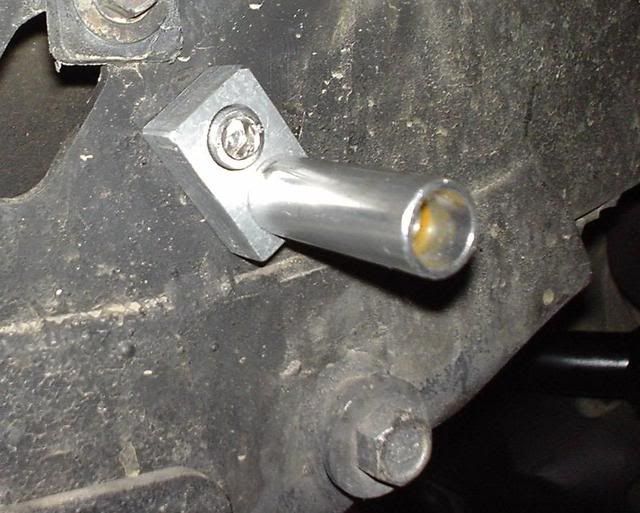

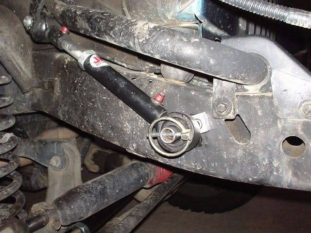

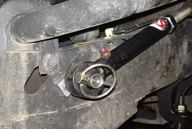

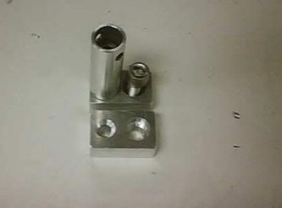

Quick Disconnect Stow-Away Cams
So when I drilled and tapped my frame for the JKS disconnect attachments, I didn't measure anything I just kinda marked it with a sharpie, eyeballed and started drilling in my haste. Well they were not lined up on each side and were just a massive pain to force into place for off-roading. So I invented some cam bolts basically to fix the issue. I figured the arc of both sides has to intersect someplace!! So, a little bit of time in front of the Bridgeport and bingo the result is awesome. I dialed in both sides, now I can effortlessly disconnect, stow, and then reconnect the sway bar. No spitting grease out the bushing, no grunting, no cussing, they slide on and off stupid easy. Why didn't JKS think of this!?
They're basically a 1/2" thick billet of aluminum about 0.65" wide and 1.2" long with two holes in it. One hole is tapped for 5/16-18 UNC, and one is a thru hole. Very simple to make. I used a Bridgeport mill, but all you really need is a hand saw to cut the pieces, a vise to hold them, a 5/16-18 tap, a power drill, and most importantly Q and F size drill bits. The Q is the oversize free fit bit for one hole, the F size is the tap drill bit for the other. I countersunk the thru hole for a stainless socket head cap screw, but you could use a button head or hex head for clearance, or just make the cams bigger. The stub is held on by the bolt included by JKS.
Spin both sides till the discos fit perfectly, tighten when done.
With the sway bar disco'ed:
This is one of those simple things that makes life a little bit easier

That's bloody brilliant! I've been having this same issue with my JKS storage pines... definitely added this to the list!
