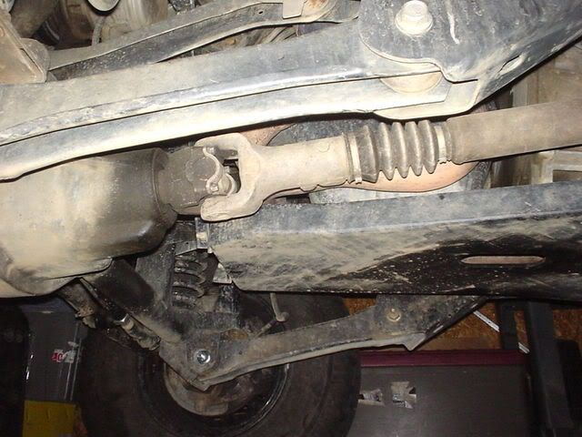

Finally got my cam bolts installed today. Eyeballed it, then drove to the nearest Firestone for my free lifetime alignment. Waited in line forever, but found out I got my caster to 5.7*/6.0* (D/P). Toe was messed up somehow...was nearly straight at 0*.
Would going from 4.0* to 6.0* caster cause toe to move out 0.28* (total)??? Either that or my lift is still settling .
Steering wheel return-to-center is much better, much smoother at highway speed, far less wander, but still a slight harmonic vibe at 50mph. When I hit a horrible bump @ 65mph in the construction zone/torn up highway, the Saturn in front of me almost lost control and my Jeep almost went into DW, but it only wobbled about 4 times, progressively decreasing and stopped as soon as I took my foot of the gas.
Cam bolts installed:
Pinion angle still looks good:
Next up...finding a ZJ tie-rod and fixing the JKS front track bar issue.

Changing the caster will result in a slight change of your toe due to the rotating of the axle changing the relative distance between the knuckle mounting points and the pitman arm. Very slight, but noticeable.

these are Zone Off-Road cam bolts from Ebay. I don't have the $500 ish required for Rokmen arms at the moment, so these will work indefinitely if necessary. The stock arms aren't that bad, they're pretty strong for what they are. Mine aren't bent, so I've really got no reason to change.
Keep in mind I'm a perfectionist. I didn't like the wander and how easy it was to over-correct on the highway with 4.0* of caster. I also wanted to eliminate my slight steering harmonics at 50mph. I didn't get a chance to give a good, long distance, quality test @ 47-50mph with the new toe & new caster, but with ~0* of toe and 6.0* of caster it was still present.
It definitely drives better, and it was doing pretty good before. Its two fingers on the steering wheel on the highway, still has a slight pull to the right...same as it did bone stock .
So yes, for under 3" of lift, I'd say they are definitely worth it if you don't have a reason to replace your stock arms. They do their job, and they're very easy to install
