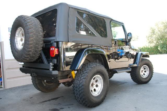

Did little work this weekend. We replaced the D44 with a 8.8 and changed the wheels and tires. Since we are now running 35s we had to get a rear bumper and tire carrier. I took the 4.88 F8.8 out of the 03 as I'm putting in a HP60.
I cheaped out and got one from 4WP as I didn't feel like making another one. I got the Smittybuilt. The bumper itself is good quality but the QC is not. First none of the bolts that were supplied to fasten to the cross member would screw any further then a few threads. Basically I had to use 1/2" impact and run the bolts thru before I could mount the bumper because they were so tight I could not do it from underneath.
The tire carrier hinge is friction pivot and is it tight but the grease nipple will get sheared off if you open the tailgate to far. I also had to grind the edge of the pivot clamp so it would not hit the tailgate hinge. I think they built it on a Jeep that had a body lift. None of these issues would arise with a BL.
Here are some pics:

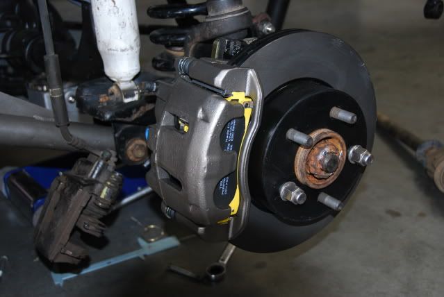

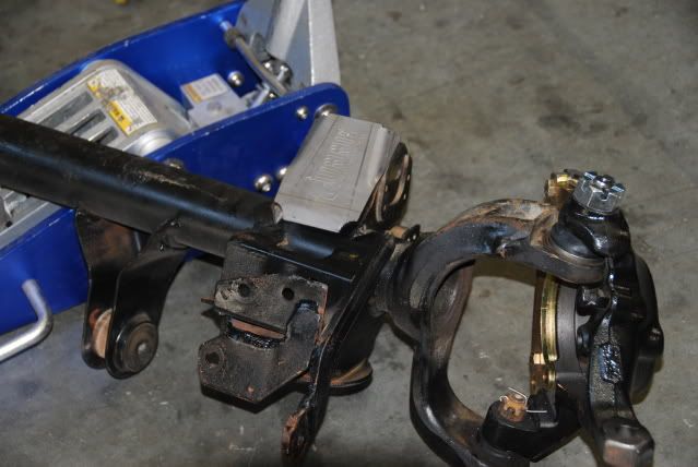

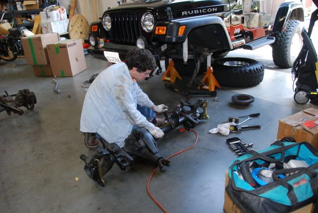

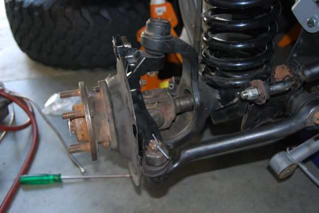

With the help of NikVallens, we got a little bit of work done on the LJ. I have wanted to put the front D44 back in. Currently I have 4.88s and I like 4.56s better. So, along with the Rubi D44 4.56ís I also put in the Superior axles chromoly shafts and CTM u-joints. A Vanco 15Ē Big Brake kit was also installed.
Nik ripped the temporary D30 out in about an hour and we got the D44 ready for the install. Nik welded some Currie LCA skids on for me. He did an OK job for a rookie but it is easier to learn by doing it. He also drilled out the track bar mount to accept the adjustable front.
All I can say about the Vanco Brake kit is WOW! I now have a tactile feel of the brakes. Meaning I now can feel when the brakes are actually going to stop the wheels from turning. The brakes are unbelievable. I have never had Jeep brakes like these. I now have to modulate my foot pressure so I donít lock my tires up! We had a little fun shaving the tires down.

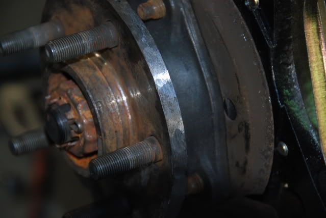

The install of the brakes is pretty straight forward. Nik did need to grind the unit bearings down a little. Since I have a few unit bearings we took a couple of them to the bench grinder and took off a small amount on the edges so the rotors would fit.
