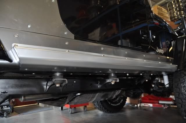

Dang Gerald, those look nice and along the lines of what I am looking for. How long are the step sliders from end to end? BTW, I love the black chrome look, very sharp.

These are the new step sliders.

Hey Lawrence,
The steps go from flare to flare and are 57-1/8" at the row of bolts on the step. I heard a rumor that a tube step is also in the works!
Awesome, on the wish list along with the tailgate stuff.
