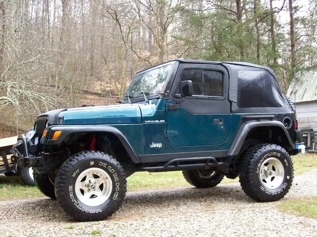

Making one is not too hard, There are several posts on how people have done them. I built one out of Aluminum. If you build your own, coming up with a design that will support the transmission is probably the hardest part, I used a separate transmission support simular to the 33 engineering one.
Key things.
You will need a SYE and adjustable rear upper control arms "especially if included with a with a lift" as it makes some steep driveline angles.
You will proably want a 1" body lift, could work without one but would be tight also depends on how flat you want to go
Transfer case shifter relocation bracket ( I had some binding in and out of 4WD, this corrected it)
May have to bend your shifter a little, Mine just touched the ash tray when in 4th.

that looks pretty good...2 things: did you spary everything down with PB Blaster or something (in the under shot) and is that a Viking fastback soft top (how do you like it?)
