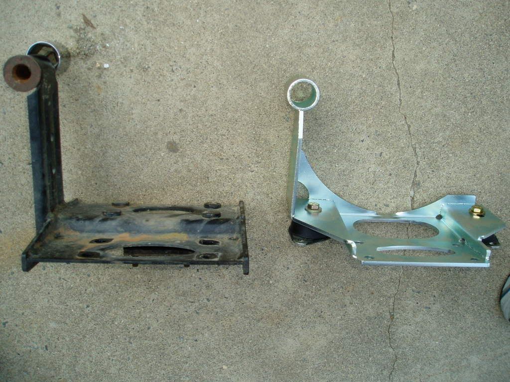

Here are the 33 Eng tranny mount next to the stock one. The Bushing on the piece sticking up is where your exhaust hanger goes in. My guess (as my application was custom) is 33 Eng expects you to get their mount. Where as with another manufacture you might need to shorten the bushing support. You can see in the pic that the 33 Eng mount (new and shiny) has a lower bushing mount location.
I did a quick review of the tranny mounts see the link in my sig.
That being said with my Flat TC skid which raised the TC as much if not more than the 33 Eng one and more than teraflex I had to trim off a little tail pipe so it would not rattle on my trailer hitch.
