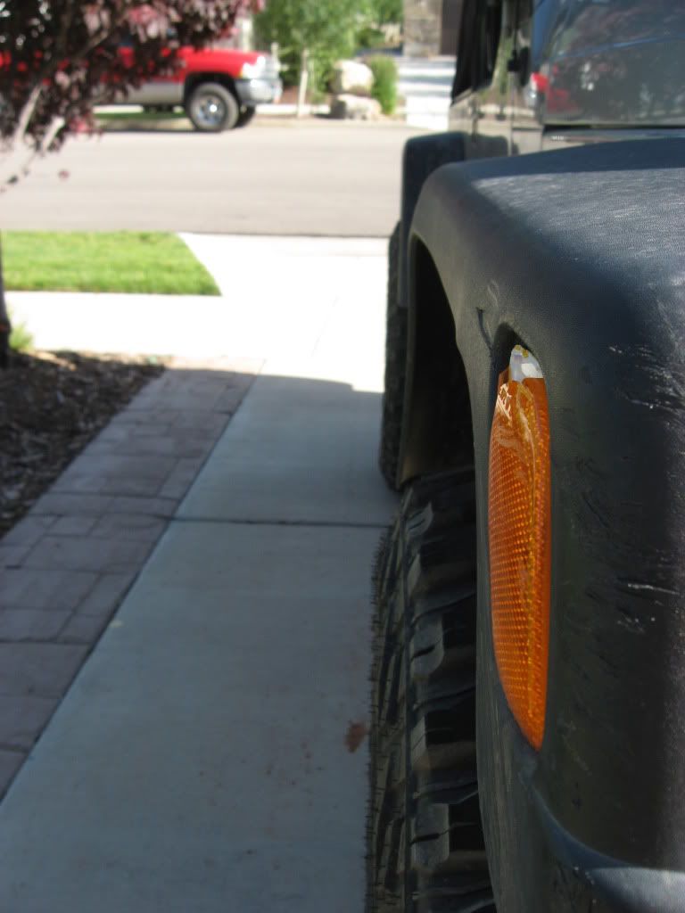

Shot of flares- The tires stick out just enough not to be elephant ears, but not enough where I will get hassled by cops.
whats the offset on the new wheels, love how they line up like that. Would like to keep it similar on my LJ build.
Here are the wheels I bought and the specs on them...
http://www.4wheelparts.com/Wheels/Xt...n=PXA1069-5865
