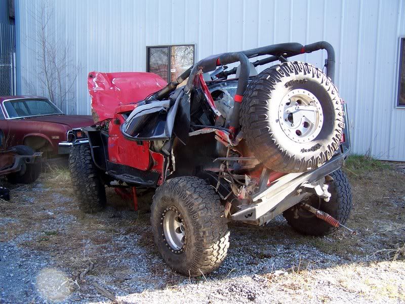

The spare tire carrier on your bumper will take the weight off your tailgate, but I dont think if you come off a ledge and hit your spare it will save you from damage. My previous truck was a ford bronco, I stood it up on its rear end one day trying to drive up a hill, the spare tire pushed in the tailgate, warped the rear panels, and broke the rear side glass. Then again if I didnt have a spare on there, or had a spare on a rear bumper I imagine the damage would have been similar.
