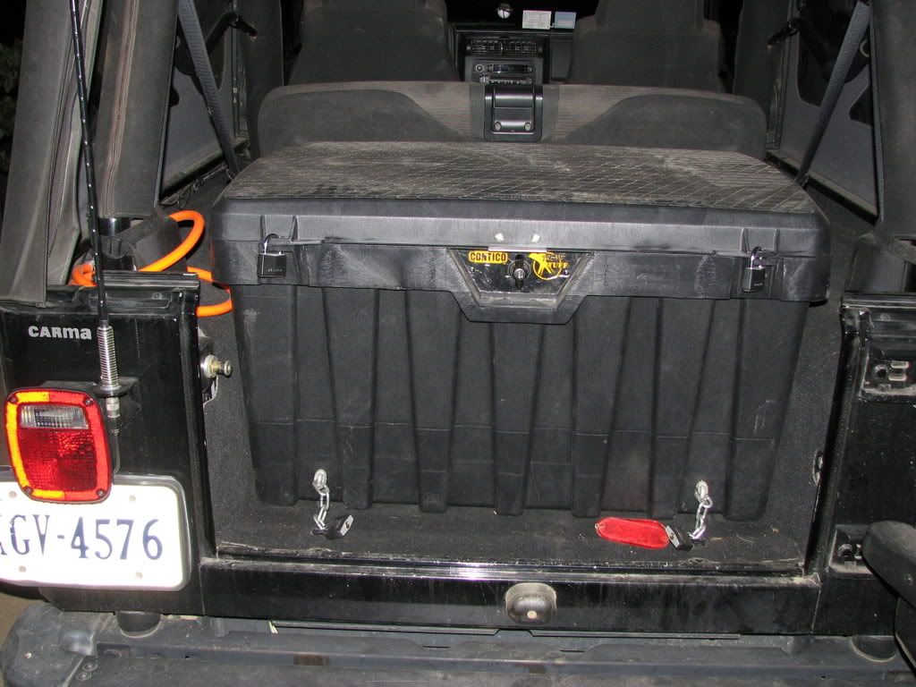

Heres what I did. I am very happy with it and it was cheap.
http://www.jeepforum.com/forum/f9/contico-tuff-bin-installed-unlimited-w-rear-seat-590637/
