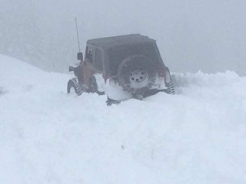

How about 5' of snow on tru-tracs?
Im the one that gets trail break duty because i rarely get stuck...
OK, this looks deep, but 5 feet?
