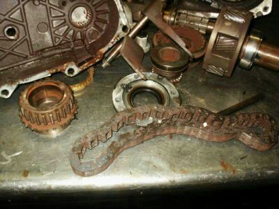

It will be fairly straight turned up on it's side in your hand, not looking like a rainbow...
toast... if it looks like this!

How does this one look?
Ive gotten some clunking when accelerating in 4WD both Hi and Low. I tore my transfer case apart yesterday to check things out.
I found a small spring that looked similar to those used in the A/C system to hold hoses together except it was broken into a few pieces inside the rear output shaft housing.
I also found some side to side play of the input gear inside the planetary gear setup. I can't find anything in the FSM about play in this setup.
Otherwise everything looks good. Even the plastic pads on the selector forks look brand new.
