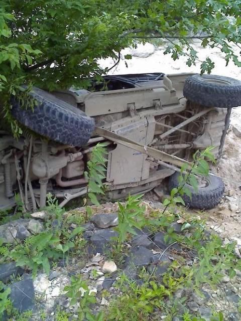

super cool tiny mufflers that sound just okay with a turn down just past the belly pan. duh
I believe in my build theres a pic of my jeep with the belly facing the sun where you can see my setup pretty clear. Ill see if I can find it.
Recoil is offline
post #14 of 28 Old 08-31-2010, 08:48 PM
Recoil
Recoil's Avatar
1988 MJ Comanche
Location: Indiana
Posts: 1,863
whoopsies.
if you look close you can see the little pipe coming off the pass side of the belly pan. Thats my fart can.
enjoy
