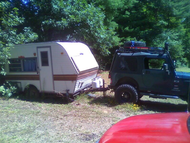

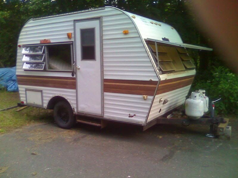

just so you can see what im talking about because i dont know much about campers so i dont even know where to begin to describe this thing lol i just know it's a "sun 'n fun"
