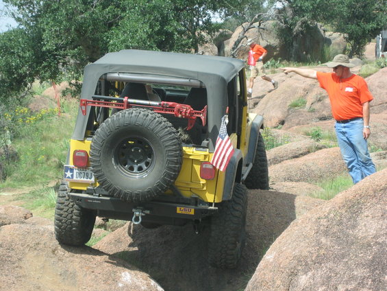

I also made a mount for my Hi-Lift:
Here's our group, sponsored by 4x4fun.com!
Staging:
I also found out that 12-13 psi in these Maxxis tires is way too much. On day 1 of the event I was aired down to 10 psi and the sidewalls were still barely flexing. On day 2 I went down to 8 psi!! In hindsight I shouldn't have done that. If I'd lost a bead in one of the situations I was in I would've easily rolled. I need beadlocks now.

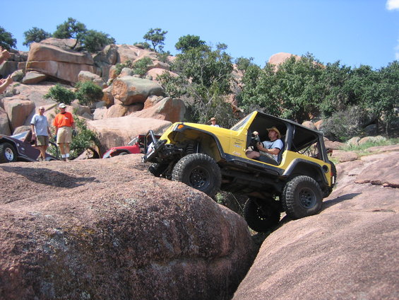

It was mid way though the day I noticed the Jeep was doing the "spool lift" pretty badly. It was at a break area that I noticed my rear sway bar endlinks (PLASTIC!!) was broken so I was running with no rear bar! Given the off-camber situations we were in that made for some very, VERY scary moments.
Here's a pic showing how the Jeep jacks when taking a tight left hand turn on a grippy surface like granite. I'd turned the wheels to the right in an effort to flatten it out before we got out to have lunch:
Scary as hell!!! Especially when you consider I was only half way through the turn at the top of a mountain with a steep drop off.
Fortunately, I managed to get through the day without rolling it.
