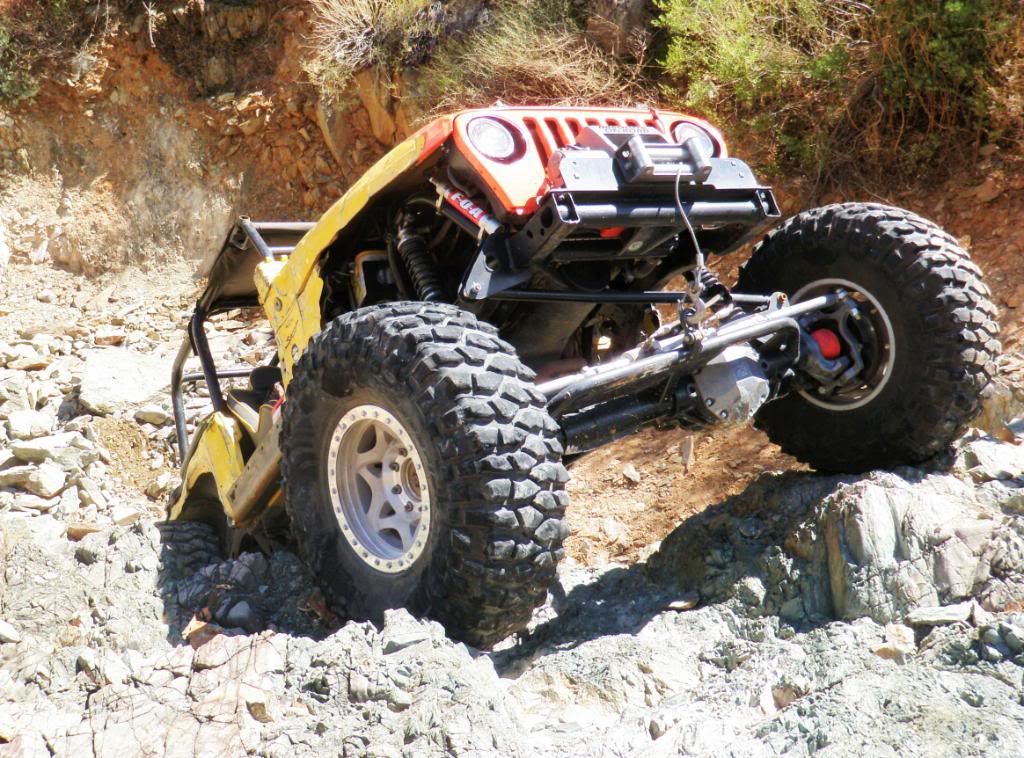

8 on 6.5.

I hate you and everything you stand for.. so when are you going to bring that machine my way? I can find space in the garage.
In all seriousness, I love Hutchinson Rock Monsters, and the Walker Evans Beadlocks, oh and the KXs look great! Believe me if I could run either of those I would then I could skip all these other shenanigans.
