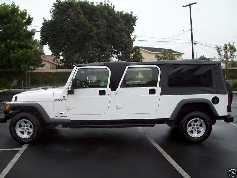

wouldn't adding 10" make it an LJ?
Sure looks like one...
And here is his "redneck soft top solution"...
I would think simply finding an LJ would be an easier solution; but considering what he already had invested in this rig, I can understand why he did it!
Cheers! M2
Cheers! M2
I wouldn't bash this guys soft-top too quickly. This rig is obviously not daily driven, thus no need for a super-nice soft top. It's a good attempt at a soft top that is probably rarely used, if at all.
BTW; that's a pretty damn nice rig.
