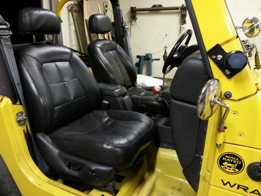

I needed to deal with the front driver's seat of my '03 TJ which was looking pretty bad. The options were to reupholster, recover or replace them. I chose to replace both seats with a set from an auto wrecker. My basic criteria was black vinyl seats from a 2 door of some sort so they would fold forward. Seat heaters would have been nice but weren't essential.
I must have looked at 150 cars at the wrecker I went to. The 3rd car I saw seemed to fit the bill (except for the heaters) but I had to look at them all ... "just in case".
I got a set out of a '03 Hyundai Tiburon and they turned out great. The hardest part was to determine what parts from each set of seats I needed. In the end I was able to keep both sets of seats in tact and build some simple brackets to make the Tiburon seats fit. The only modification I had to make to either seat was to cut away a small amount of plastic from the base of the seat on the driver's side to clear the Jeep seat belt mechanism. It made no real difference to the appearance.
Here's how they turned out ... very comfortable!
And from the back. Even got a mesh storage net.
Simple bracket made out of flat bar. I will remove the seats, paint the brackets and use grade 8 hardware. They can now be removed easier than the original seats.
Nice thing about this type of head rest is that I can hang a back pack (or ?) from them. This is my old first aid kit from Scouting.

What did you do for the sliders?

I used the sliders from the Tiburon seats and they work fine. I wanted to keep both sets of seats in tact vs. using bits from each.
The only thing I have to do is make a cable pull so the passenger's seat flips forward like the original did. That will be pretty straight forward.
