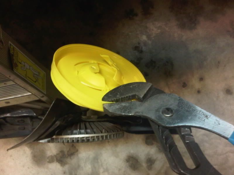

That must be a big set of channel locks? What is that about 5 inches?
Nope, you're still thinking of it wrong . It's like this!
Pretend the plastic yellow cap is the pulley.
Got it now, Duh.
