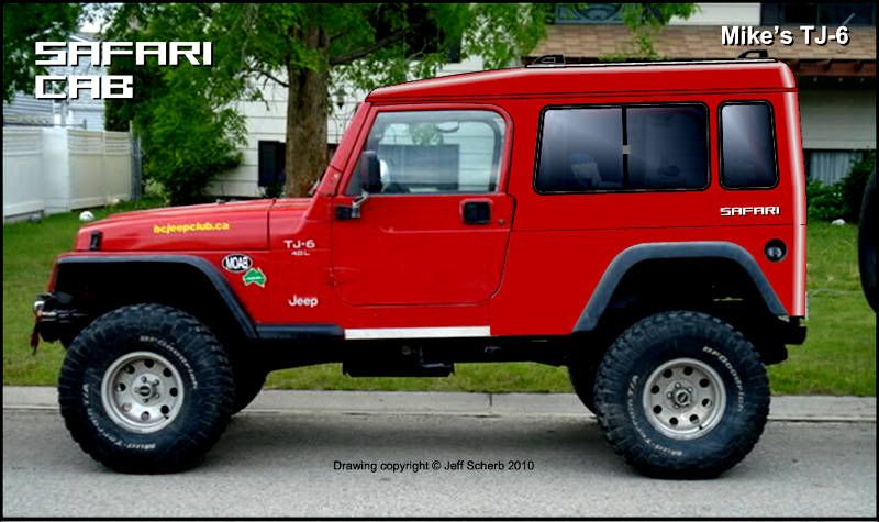

The LJ is longer than the TJ between the door and the wheelwell, and behind the wheel well, so if you wanted to exactly duplicate an LJ you'd be stretching it in two places (and don't forget stretching the inner fenders in two places as well).
You might consider stretching the TJ between the door and the rear wheel well. You could end up with the correct LJ length, but you'd have a slightly longer wheelbase. The cuts could be made right behind the door b-pillar, so you probably wouldn't have to stretch/splice the inner fenders.
Here's a photo of one stretched like that (you can ignore the hardtop drawn on the photo, sorry I don't have a photo without the hardtop), he calls it a "TJ-6":

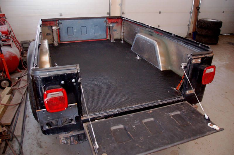

You could stretch a tub to any length you wanted by cutting it between the doors and the rear wheel wells as in the drawing above, and filling the space in between with new side panels topped with the top edge cut from any year CJ/YJ/TJ tub. The new side panels can easily be made from sheet metal.
That's how this trailer was built:
And in the process the inner fenders were removed, and replaced with minimal-sized ones (for a Jeep they'd have to be a little larger because the wheel travel on a vehicle is greater than on a trailer). By swapping the big old inner fenders for something like this you get a much more usable bed in the back:
Just another approach to consider...
