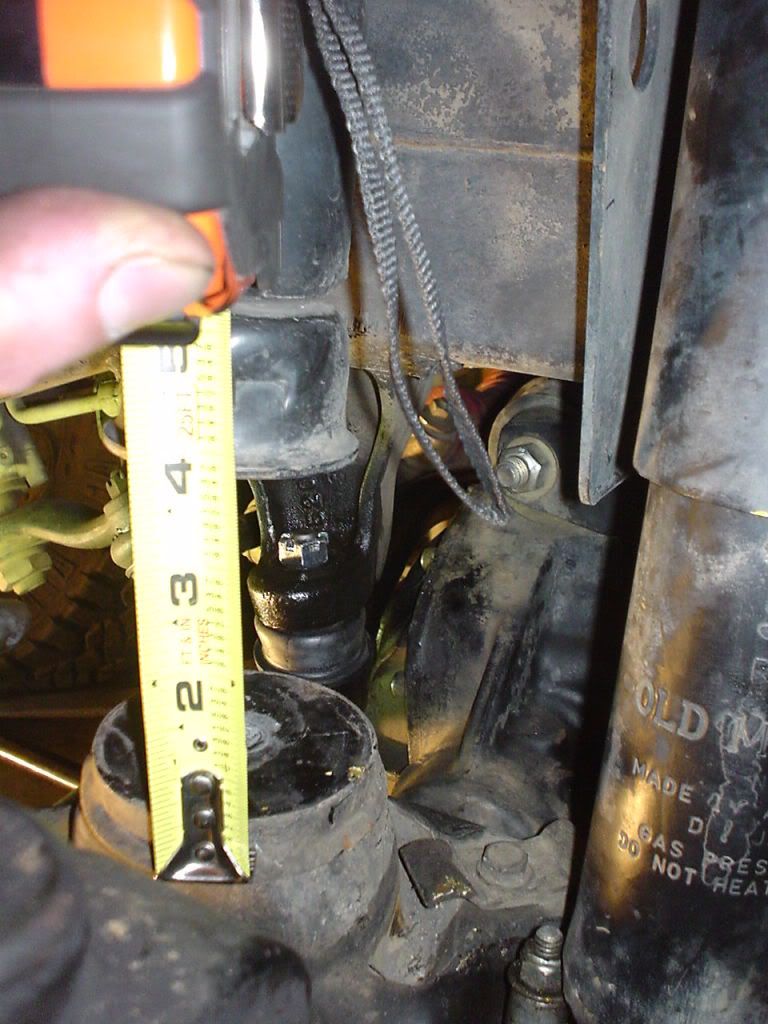

that looks like an interesting idea, and based on their measurements it looks almost half the height of the stock mount...which would probably work well with a flat-ish pitman arm. the 2.5" JJ width would suggest an overall width close to 5" by the time you get a grade 8 bolt & nut in double shear....and that's definitely too wide to fit between the tie-rod and diff, but it should sit above enough since it's shorter...thats one of those things that would have to be tried with approx stock bumpstop height. I'd love to see full bump pics of that Clayton double shear setup with 1" or less bumpstop extension...
Curious, you state 5" clearance between the steering tie rod and the diff housing, and the pic shown confirms that. Will the ZJ V8 tie rod gain a bit more clearance or is the bend not far enough over to make a difference?

Posts: 24,198
The picture doesn't confirm anything actually. Go measure yours and report back, that's the point I was trying to make. Obviously you didn't go measure, because it's not 5"...not anywhere close. That's my point. The V8 ZJ tie-rod and Currie will have less clearance than stock because they are thicker in diameter.

Posts: 2,384
The picture doesn't confirm anything actually. Go measure yours and report back, that's the point I was trying to make. Obviously you didn't go measure, because it's not 5"...not anywhere close. That's my point. The V8 ZJ tie-rod and Currie have less clearance because they are thicker in diameter.
No I didn't measure yet.....I was just using it as a base example point. Regardless, I know the ZJ tie rod is thicker, but I thought it bends forward gaining clearance.
it doesn't bend forward, it bends downward. but the bend is in front of the pumpkin, after that window, regardless.

Posts: 2,384
Regardless I have 4.25", but call it 4" if you want.
and that's the point...you end up needing to fit a 4"-4.5" bolt in that space (if using a 2" JJ & standard grade 8 hardware). that's why you see people use heims...to get a smaller mount profile. mudb8 did CB3's rig with a 2" JJ on a bit of an angle, taking advantage of the misalignment possible to squeeze the bolt in there....he's got pics of that in this thread and the build thread.
