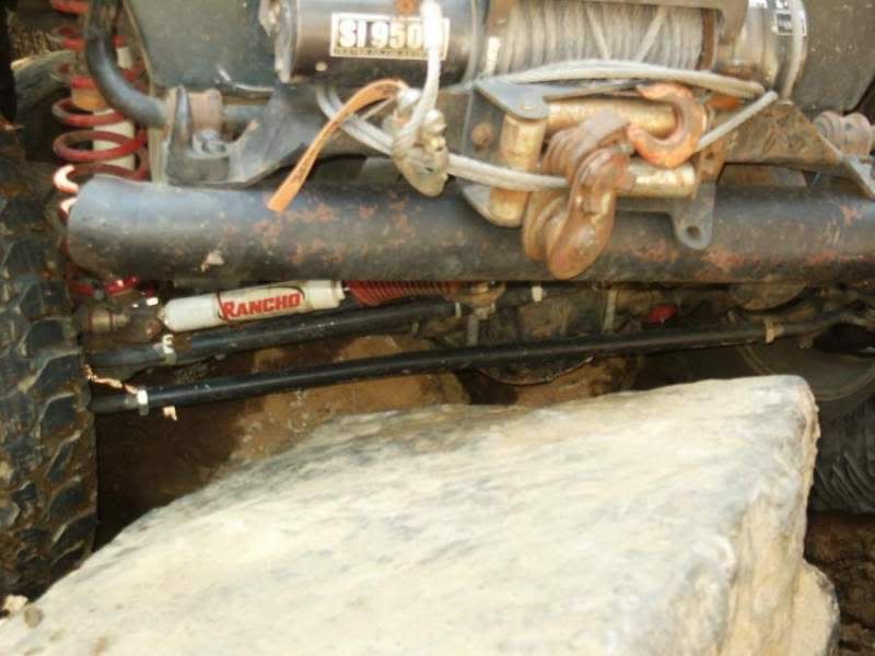

Originally Posted by mudb8 View Post
I have the same WJ knuckles, and steering links as you do with the nth frame brace... it fits awesome.
You have this drag link end?...
Knuckelhead is offline

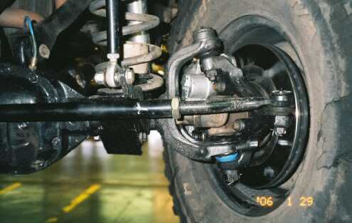

lol, I think I said similiar... I saw that.
did you make it?
I need to goto a 1ton tre and flip the links..
did you make it?
Yep.
And I flipped the links.
The track bar was a re-do also...

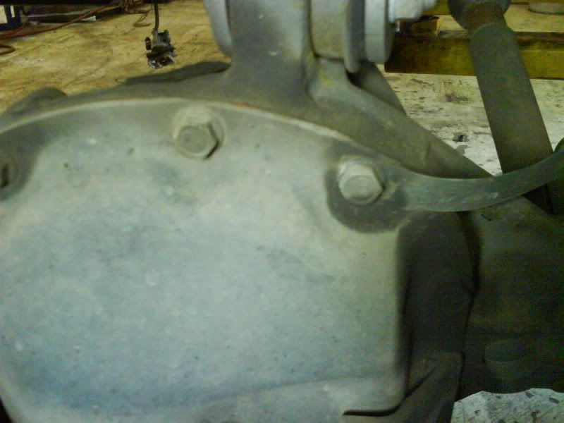

just got this in the shop today...
RE 3.5" lift with 2" bumpstops, 24" re shocks....
the RE track bar hits the stock diff cover...
all the links and alignment is properly adjusted also...
so... as I said............
PROVE IT
if you think your RC, RE, FT, Rusty's, BDS.... ect.. track bars don't hit at some point in the game...
