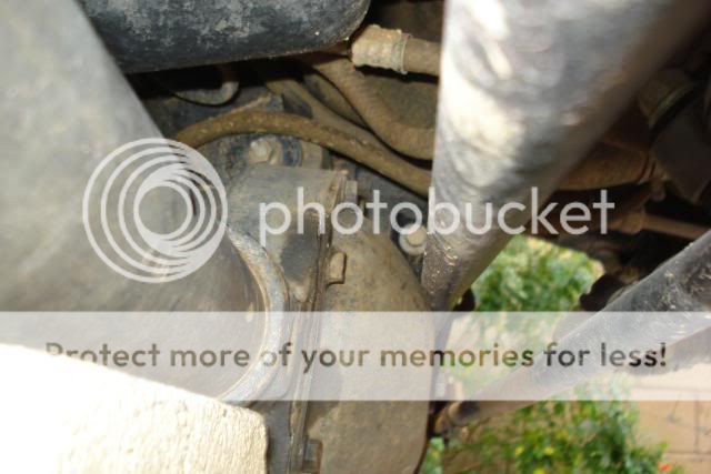

Originally Posted by JFcavedweller View Post
i have the RC 0-3.5" lift's adj. track bar (theres a different one for 4-6"), and im not sure if its gonna be a problem or not. sitting level, theres about 3-4" clearance between it and the diff. i have the RC 3.25" lift kit.
these pics are with maybe 80% flex, right front wheel dipped down
wait till your tie rod gets bent/hooked from the frame side track bar bolt......

post #939 of 1784 Old 04-11-2011, 02:14 PM
JFcavedweller
Location: Lynchburg
Posts: 417
i definitely don't get the feeling that its close enough to be an issue
So this moved the trackbar forward and farther to the drivers side? Do you have better pics of the mount and the bracket?
you don't even have to show me full bump pics and i can see its an issue. i'd guess it needs at least 2" front bumpstop just by looking at it. check out my pic, and see where the flex joint sits realitive to the straight part of the tie-rod...yours is moved forward and down even more...the bolt is going to hit the tierod.
i'll definitely check it out and get some new pics as soon as im able. should i flip the bolt around or do you think it would still hit? i need bumpstops anyway just so my tires don't hit the fenders.
