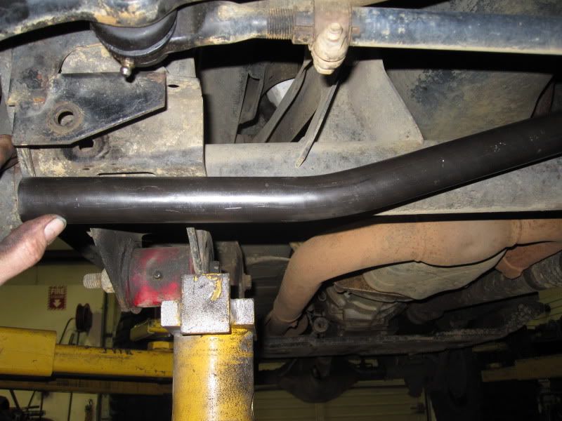

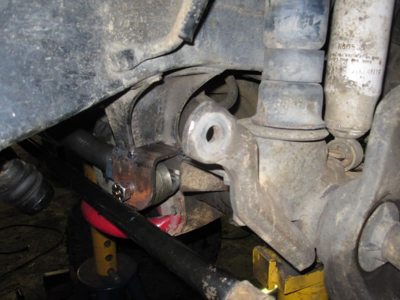

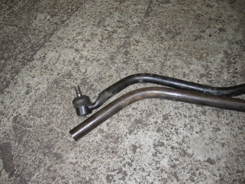

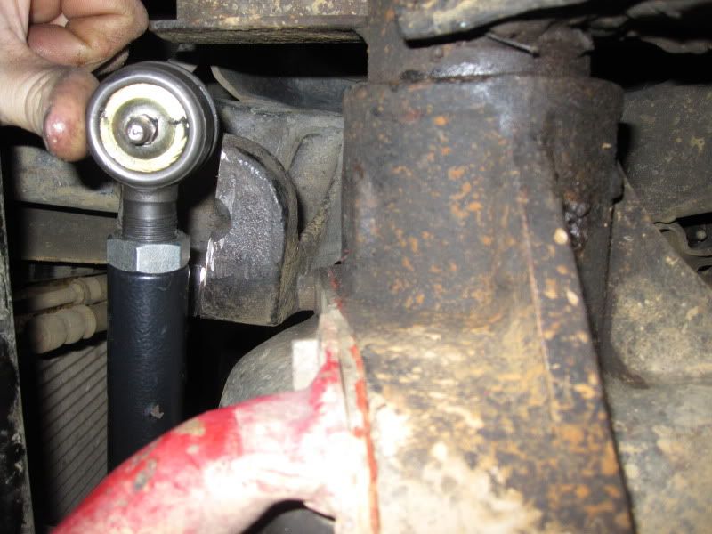

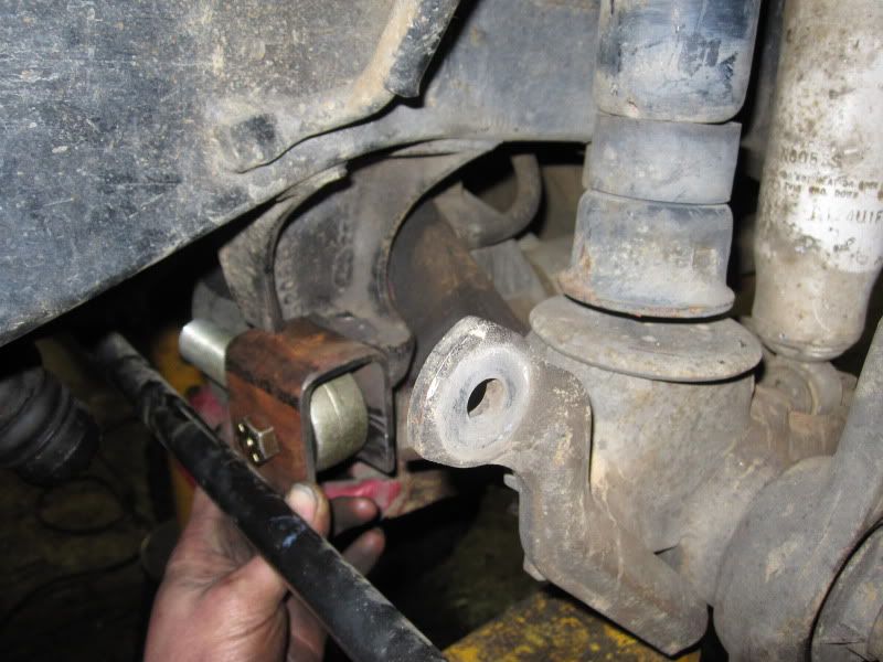

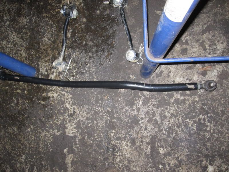

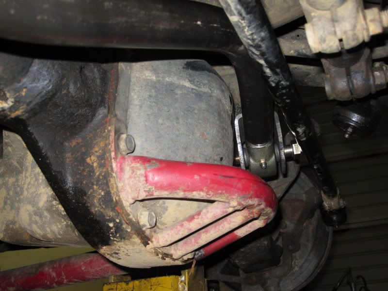

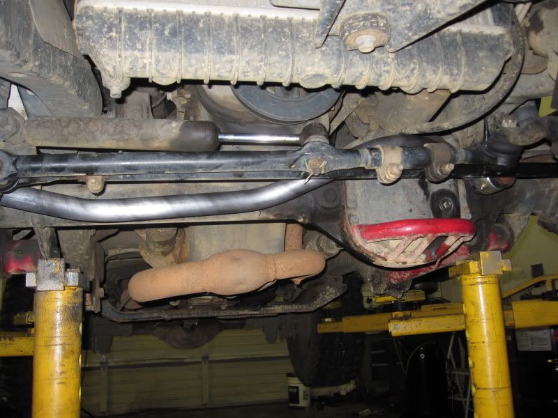

Rough country Track bar...... needs more bend to get around the stock diff cover, the Tj is sitting on 1" bumpstop extension. also needs another bend at the axle end to keep it from binding on the axle bracket.
I want your factory 07-up take-off/thrown out JK front/rear Lower Control Arms! Bent ones are perfect also as long as the bushings and cold cut rings are in good shape/useable
ASE Certified Master Tech/Fabricator @ jeepwest.com
mudb8 is offline
post #884 of 1784 Old 03-15-2011, 10:53 PM Thread Starter
mudb8
want it rite or rite now?
mudb8's Avatar
Location: Estacada, oregon
Posts: 5,990

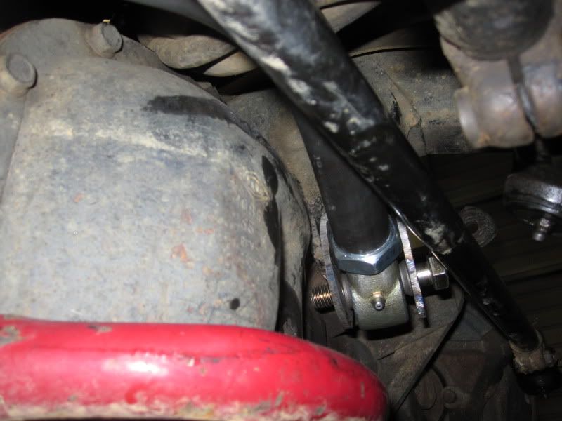

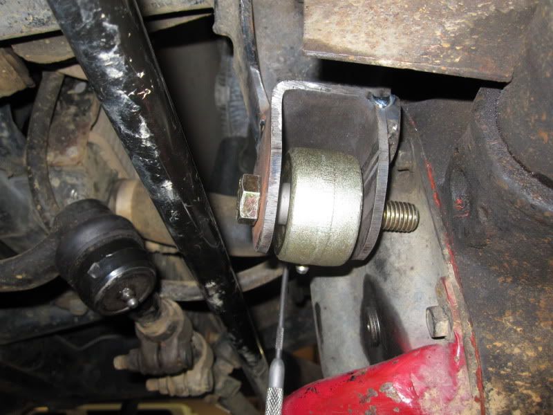

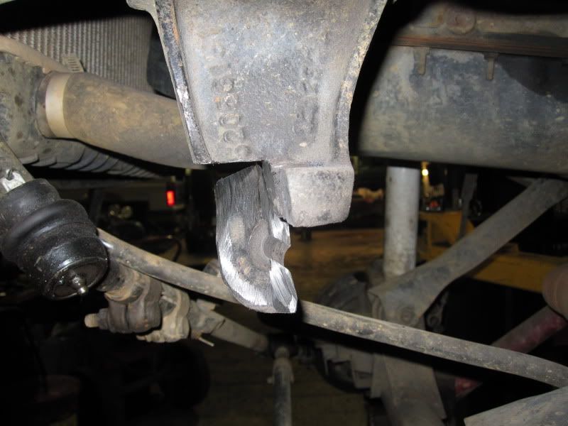

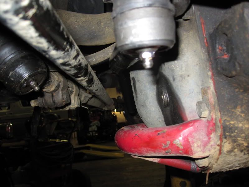

continued from yesterday.....

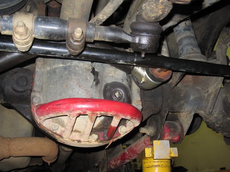

full compression, sitting on the bumpstop bell with the tires straight.
same as above but the steering is at full lock to the left...
this tells us we can't relocate the track bar bar bracket forward without having it run into the steering at full compression..

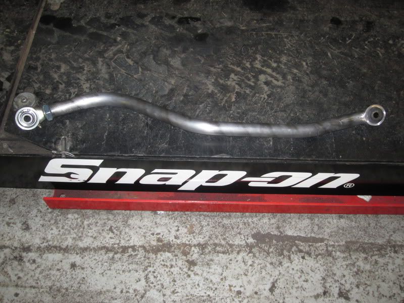

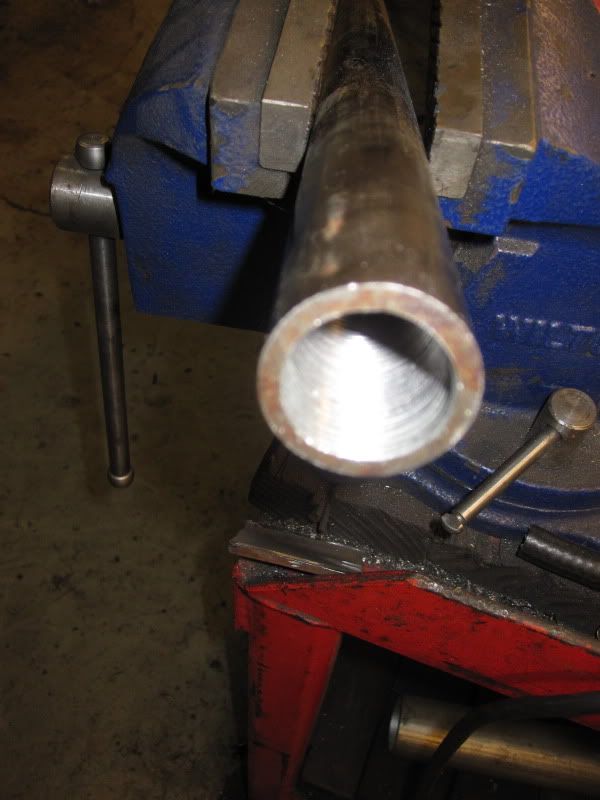

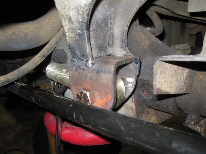

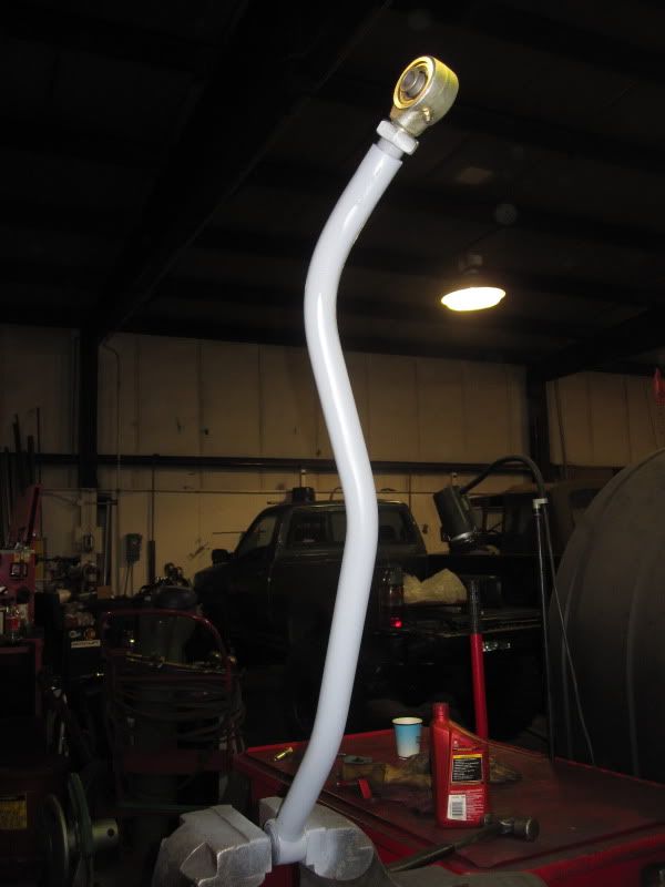

I use a stock track bar for reference when bending my bars.

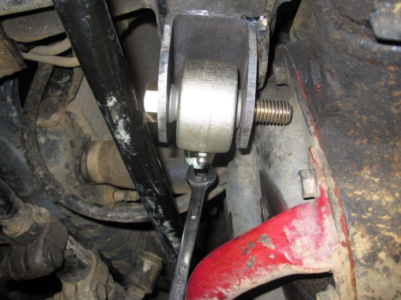

1/2" axle end clevite.... compared to RC" polly two piece 10MM
The mix.... stock, JKS WJ, My hand bent, and RC
