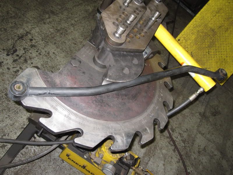

Anyone Care to guess what This front track bar used to be?
I dunno. But is the lower mount re-located farther outward, too?
Looks kinda like a reworked rear track bar.
LOL, yep, but ya prolly cheated and read the post in the other thread?
I was in need of something to put in so the rig could be moved around the shop while the custom bar is getting new red powdercoating on it...
the Rear track bar rebent for the front is not going to be an option used without over 2+" bumpstop extension (guessing of course, but based on what I do know from other aftermarket track bars that are bent nearly exactly the same), but could work just fine on lifts over 4" with proper bumpstop extension. just think of what size bolt is used on the rear compared to the stock front track bars not to mention it's a molded rubber press in bushing, not one of the two piece, pieces of crap most manufacturers are using for ease of installation that last a whole month or so before you end up with the shakes again.... Frankly, I'm suprised to see Currie and JKS has been using as well. There was a cutomer's Dodge 2500 Ram in the shop a few months ago I installed a lift on, it came back with a nasty case of DW, I found the two piece bushings to be egged out, What I used to replace them with were the Frame end bushings off of a couple JK front track bars I had laying around.(I was in a pinch had to come up with something fast) I talked to the manufacture about it since they are just down the street and told them what I had done, a couple weeks later the customer comes back with some new bushings from the manufacture made of a much harder durometer which he requested I replace the jeep bushings with. so, it lasted a whole trip to seattle and started shaking again, now I get to put my original JK bushing fix back in the big Dodge truck... Now, why in the heck people think the aftermarket polly bushings are an upgrade from stock molded rubber bushings is beyond my comprehension especially when they are used in a location that we need to have all the flex/range of motion we can get like a Johny Joint offers but can't have/dont want the bars flopping around, the polly bushings used in that application is just a recipe for problems including bent broken bracketry.
Anyhow enough of my rambling, I went back to the bender twice before I had enough angle/bend to make the bar the correct length, worked pretty good and the steering wheel center is barely off... Initially I was going to slip a WJ grand stock track bar in there but it was a bit long and I really diddn't want to bend up one of my spares.
