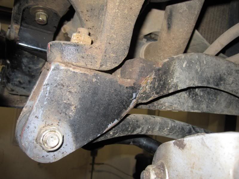

I can get better pics later on if you need them. But the side with the welded bushing end and smaller angle is at the frame side with the angle pointing up and the threaded side is at the axle mount with the longer threaded bushing you sent me. There's about 3.5 inches of uptravel before they contact

take a coworker's TJ, install the track bar, move the lower control arms to 16.25" eye to eye, remove the springs, shocks and jounce bumper. lift the axle to the bumpstop cup....see where it hits first (tie-rod, diff cover, drag link, etc). change the design as necessary. if you think you get it figured out, send it to mudb8. i'd be happy to be a tester as well

lift height doesn't matter at all for the AEV track bar, It just needs a minimum of 2" bumpstop extension along with some tweeking to keep it off the diff.
My AEV/Nth Degree HD Track bar brace failed after I managed to bend it, it keept flexing and eventually broke, I had fixed it previously from the same problem. If you Use a 3" bumpstop extension It won't even come close to getting bent from the diff.
