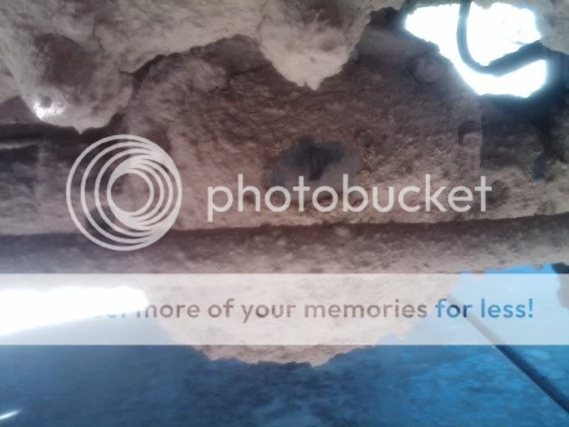

I haven't checked into this thread for a while but today i have a good example. I have the rough country 0-3.5 inch track bar. at first the track bar they sent me wasn't long enough for their 3.25 kit. so instead of a heim on the axle end they sent me a bushing with a really long thread. so i figured i gained more then 3.5 inches for their track bar not to reach. I noticed the scratch on the diff right away but i thought i had done it when putting on and taking off the track bar and letting it fall when attached to the axle end. Now that my springs have sagged and under the right circumstances i have this...
Can't argue with that.... it has nothing to do with the springs sagging, it just takes a smaller bump.
yeah that's true. Ive noticed the scratch on the diff since the beginning but i thought i had done it while resting the track bar on the diff when installing it. but now i know for sure its hitting. It sucks since even Jeffrey told me himself it shouldn't hit.
