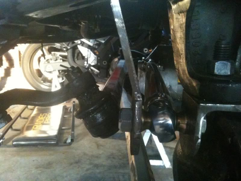

Ok.. I tried to take a few pictures of my acos bumpstops, shocks and BDS trac bar.
There is 5.5" of compression before the shocks bottom out
This is not the best picture...it's a bad angle to read the tape... but from the bottom bumpstop to the front of the acos poly bushing is 4.5" (I don't think the poly bump stop pushes in like the stock ones..it is pretty solid)
These are pictures of the trac bar... best I could do. We just got hit with a huge snow storm..everything is iced up.
In some of those pics it looks like my TMR customs alumi-flex tie rod hits the cover but it has about 1/2" clearance.
I will have it in the shop on the weekend to replace the springs... I will put it down on the bumpstops and take some pics then... anything jump out from these pics?
I'm seeing bumstop extension or acos there.....
