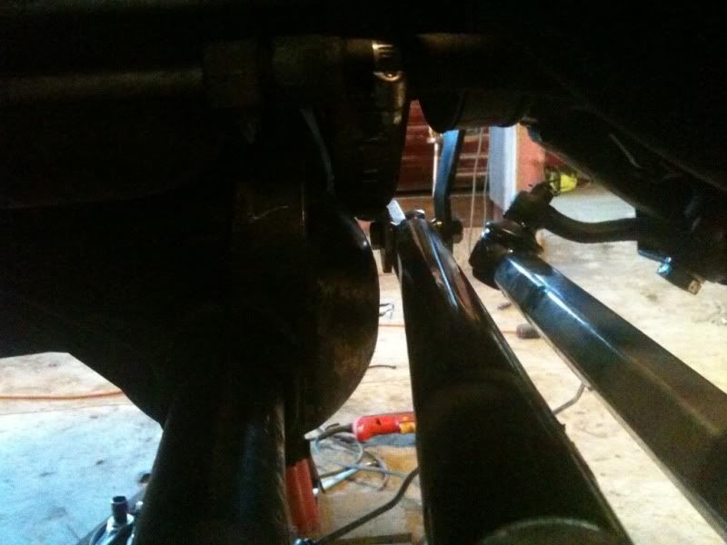

As I was planning for my build I was following this thread closely. As a result of all the information here I had ordered the 2" bumpstops and had them ready just in case. I was pleasantly surprized with the results when I was finishing the lift. As we all know every Jeep is a little different so take my results and the pictures however you like. It clears but is very close, if you have an upgraded tierod I could see it possibly contacting there. If you have a larger diff cover I could see it hitting that as well. The lift is OME 2930 springs/60047 shocks front, 2949 springs/60049 shocks rear. JKS adjustable arms, front lower set approx 1/4" longer than stock, front upper set at stock. JKS adjustable track bars front and rear. If I remember correctly it gave me 6.7 degrees caster when I had it alligned.
The pictures are after I installed everything, centered the axle, removed the springs and set it on the bumpstops. So far it drives like a dream, I have not had the chance to wheel it yet.
Thanks to Mudb8 for all the information provided on the forum!
Just to confirm - you are saying that yours clears with no bump stop extension at all?
Why did you need to set the uppers 1/4" longer than stock? To fix caster? Or for clearance of the track bar?
Do you also have a body lift? Otherwise I would think you would need bumpstop extensions just to keep the tires out of the fenders.
The setup in your profile is almost exactly what I have in mind for my rig, so I am very curious. And I have a 2005 LJ as well.
Thanks for the information.
Correct-no bumpstop extension
Actually it was the lowers longer than stock, just for caster.
Yes I have a 1" body lift, and the tires being 33x10.5 help with the fender clearance.
bgmadmxr is offline
