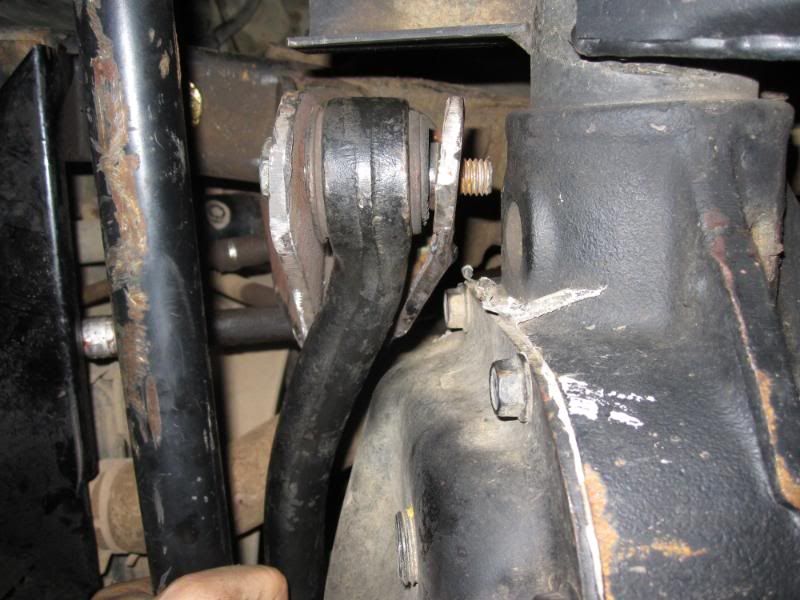

Originally Posted by EricsGreen98Tj View Post

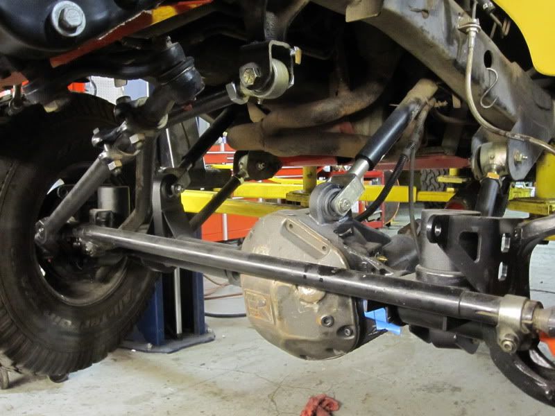

So Mudb8, does the Currie "offset" tracbar hit too, I know you said that the JKS one with the bend does but am unsure of the "new" currie one.
And MUD thanks for all the info BTW
SO "IF" i shipped you a stock TB could/would you "cure" it for me and how much would it cost?
OR should i try to cut/sleeve my spare stock TB?
Dont really want to redrill the axle bracket for fear of weakining the bracket itself...
PS: the front shocks i run are 24.66" extended and 14.79" collapsed. ZONE OFFROAD for a 3" Kit

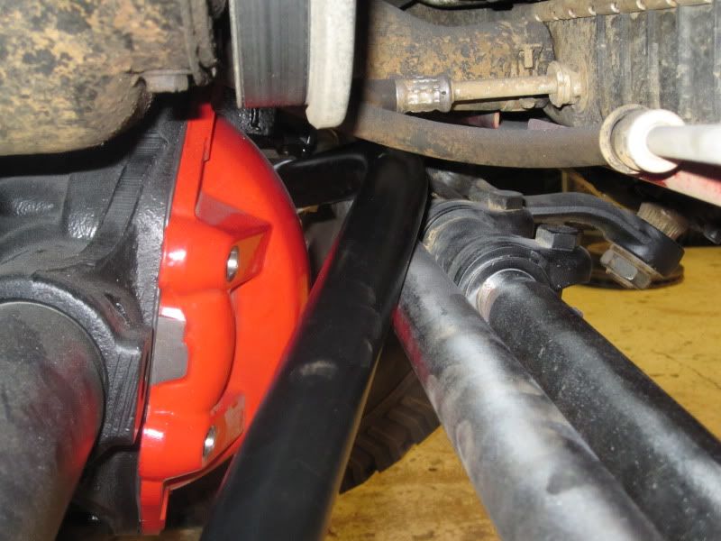

I really wouldn't feel right making an attemp to rebend a track bar without the rig present to make sure it ends up where it needs to be... I don't have a jig or anything made up.
Originally Posted by RedTeej View Post

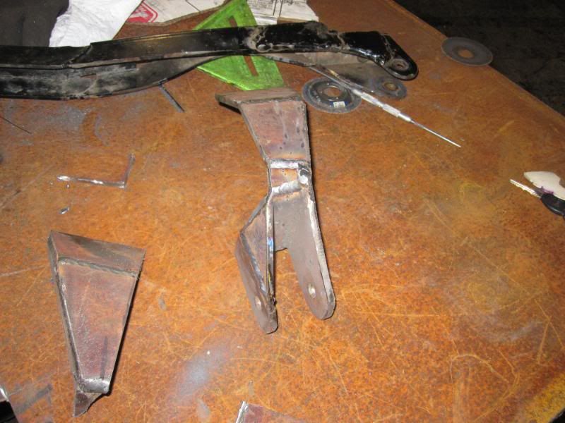

So Mudb8, what's the cure-all? Does it need to be welded on? I've got a great welder here who does beautiful work, and I'd be more than happy to purchase the bracket from you (if it's what I think I saw you post).

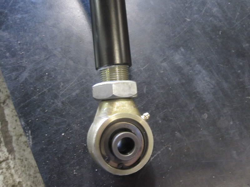

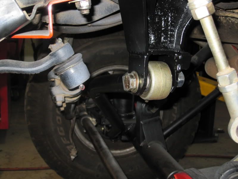

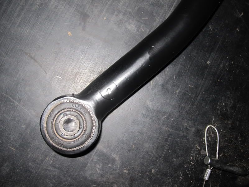

the Cure all is basically custom mods.... this is one I built for another forum member using a currie joint, scrap metal and 1.25x.250w tubing.. which happens to also clear a ARB diff cover w/1" bumpstop extension.

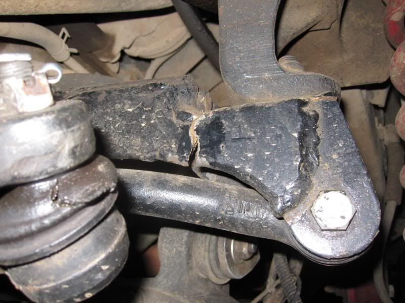

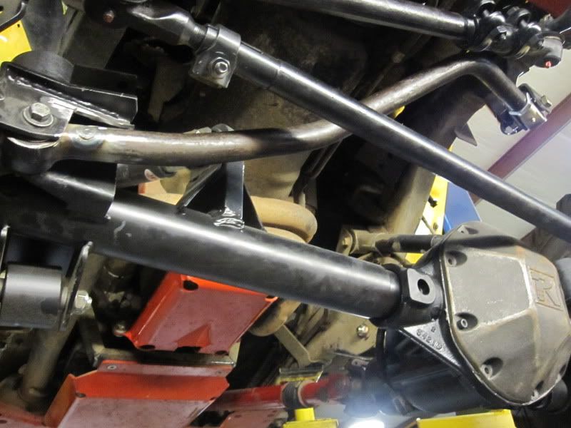

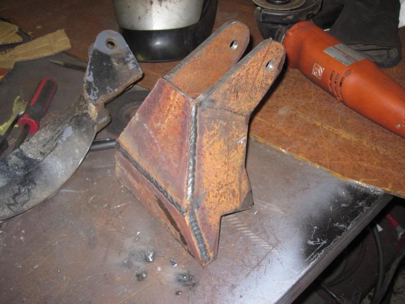

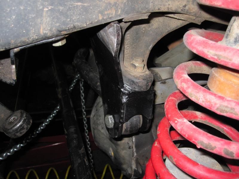

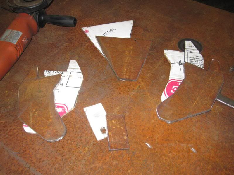

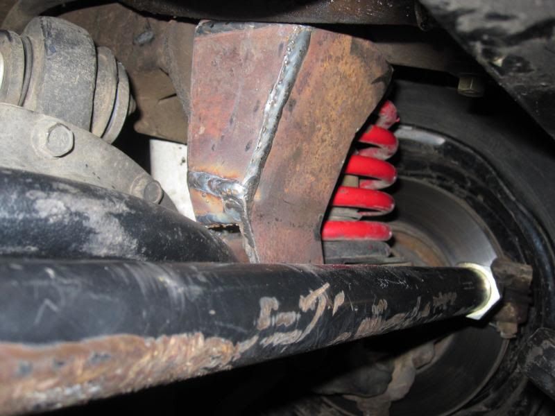

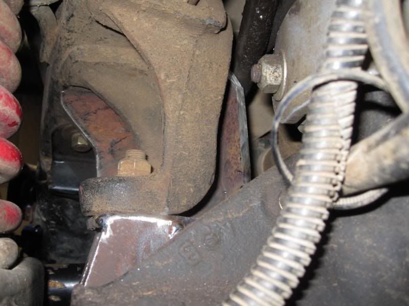

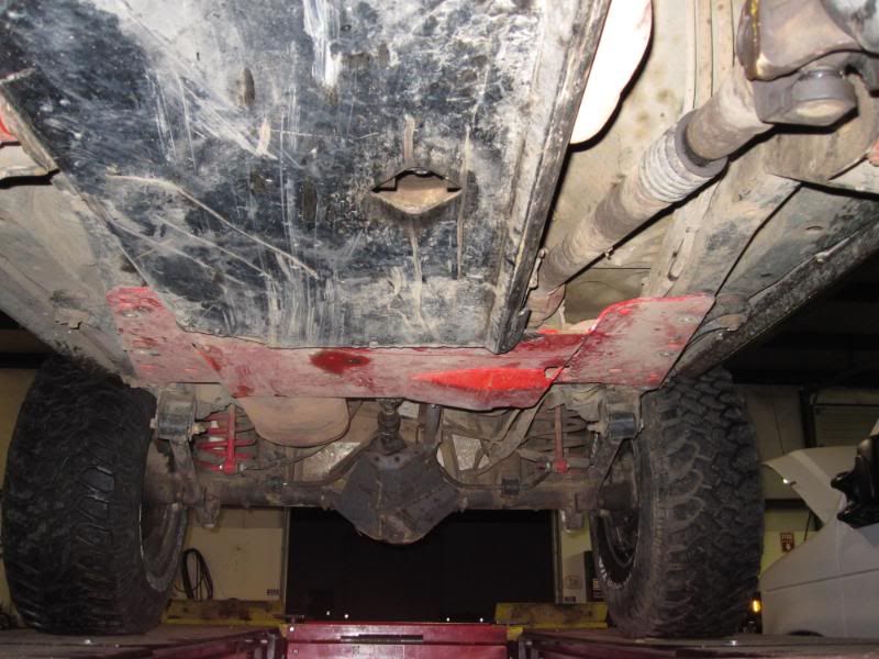

a couple days ago, I managed to finish off my Nth degree Frame brace..... LOL, don't even bother asking what I was doing since it was far from normal and I prolly have the only nth degree TT that's ever been bent! on the way to the shop monday the rubi was feeling a little squirley on the curves. It's my daily driver so I rarely ever have it torn apart for mods, At the end of the day I put in another half day fixing it, still retaining the WJ grand Cherokee Track bar the Nth Degree HD adjustable uses.
I use cardboard for everything... almost
the first attempt at a HD frame bracket wouldn't clear the upper CA or the diff housing at full stuff... but it looked good anyhow.
The revised edition...

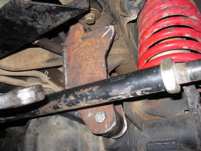

Hey mudd,what brand of CA's in the pic above use the Clevite bushings? do those hold up pretty good? Im in the market for a set of LCA's and dont wanna spend the extra loot for a JJ on both ends....
assuming you mean the rear 28" mid arms I have thrown on there, which was a quicky after I mangled the stock lower frame mounts....
They are stock rear JK arms I cut in half and slid each end into tubing and welded the ends, the bushings are kinda a bastard to get in and out for welding tho. they actually flex out pretty well and I haven't ruined them YET.
I've done a bunch of JK lifts and happened to have several pairs of stock arms laying out back, the stupid looking frame mounts I have on there are remnants of an EZ-Lift hitch, I'll be relocating those soon since I have the TT on there now. I just used what I had without spending a dime.... as usual!

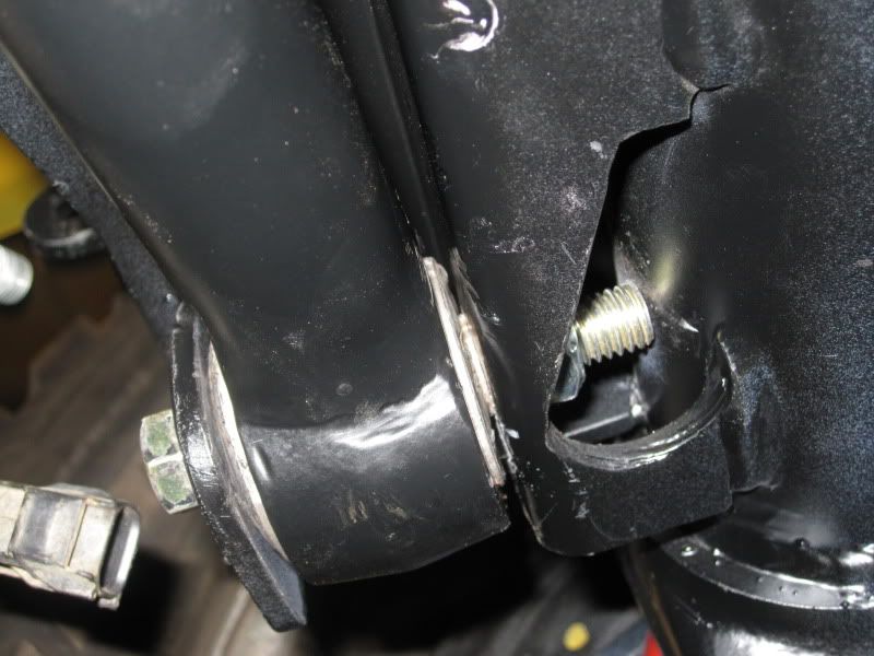

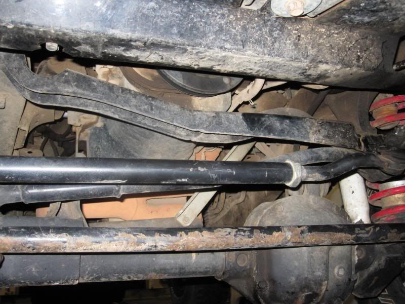

I have been following along... interesting thread. I would like to add that I have the new BDS adjustable trac bar and it fits perfectly. I have a rubicon with a 2" lift. I tried... and there is no way possible it can hit the diff cover... I will try and post a few pics.
The shape of it is identical to the stock one... just had to re-drill the lower mount a bit larger.
