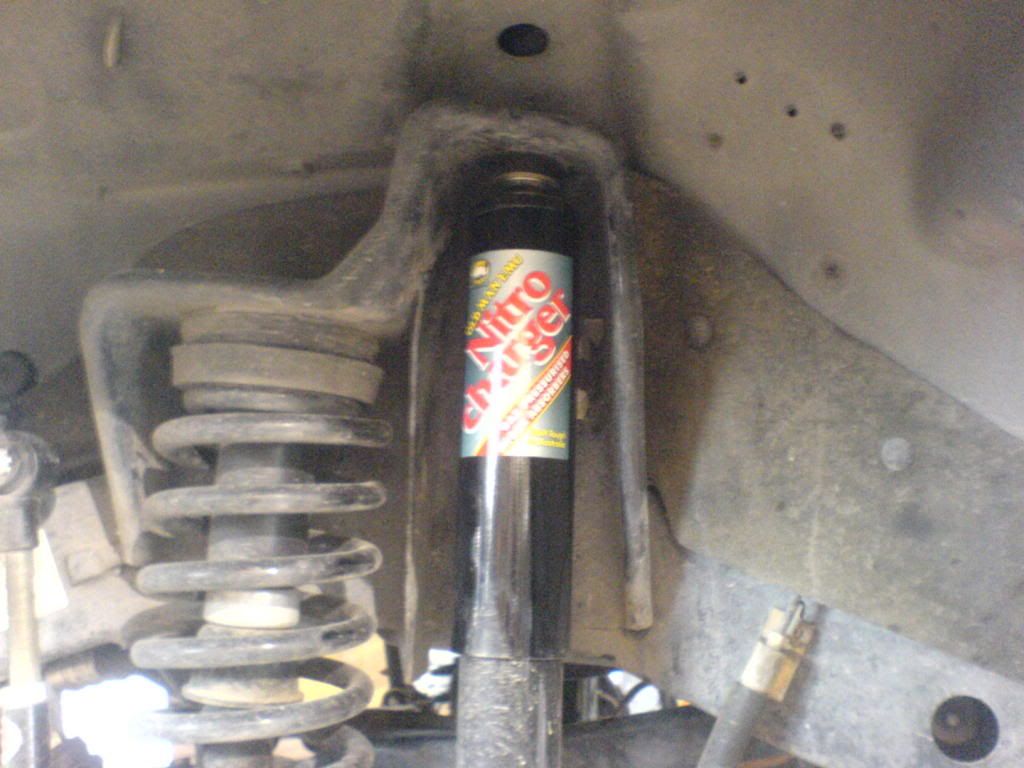

You asked for them.
Now you shall recieve.
Mine does not and will dont hit the diff.

Thats an OGS 126 if I remember correctly. I have the OME 933's up front with a 3/4" spacer. RE's 2" bumpstop and the 3/4"(?) bumpstop that OME sends with their springs. All that equates to no rub, and also not having overly excessive bumpstop.

It can go either way, I used it in the front because I didnt need any more in the rear. I needed more in the front becasue the springs game me roughly 3" of lift. It works just fine...
Look at my diff, it has never once hit.

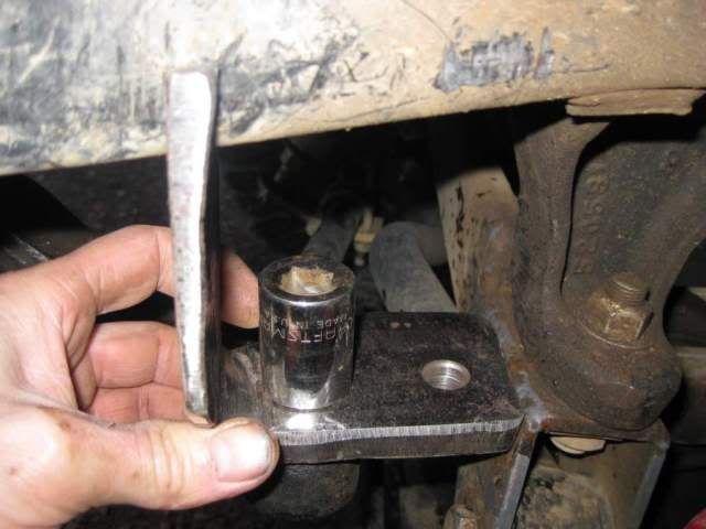

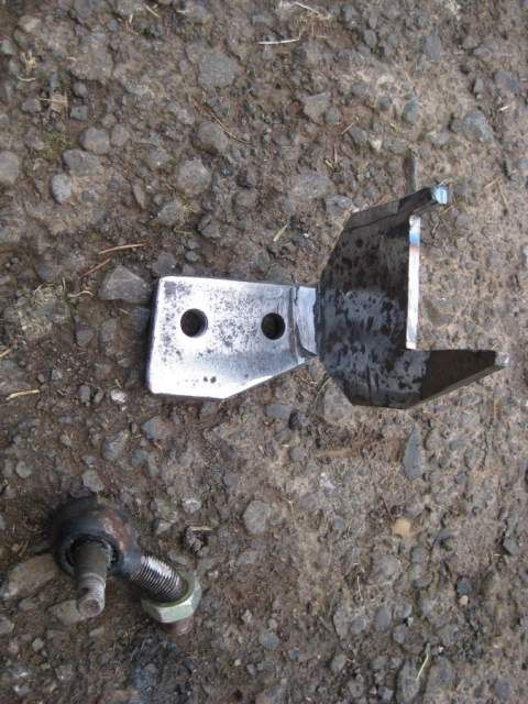

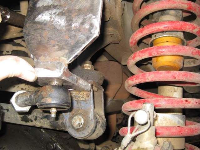

lol, I knew you'd come through for me!
that shows me the tj and wj bar have the same bends, the difference is the frame end is turned up to bolt in a double shear bracket.
my nth bracket mounts directly to the tre mount. the wj jks bar clears my diff with flying colors.. although i also have 2" bumpstops and longer than stock control arms. the nth bracket has it droped some also.
looking at my jks wj bar, i'm sure being used with a clayton relocation bracket, and I say clayton because ti has minimal forward relocation that could cause drag link clearance sissues, it would clear without any bumpstops.
