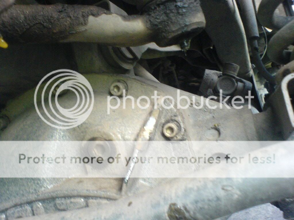

solid diff cover, rc 2.5" kit, STOCK trackbar, I have been using the lame rubber shocks stoppers as bumpstops, Looks like I gotta bumpstop for real now!
this was from just ONE day of wheeling. I am gonna do some clearancing on that particular rib, and bumpstop appropriately as well.

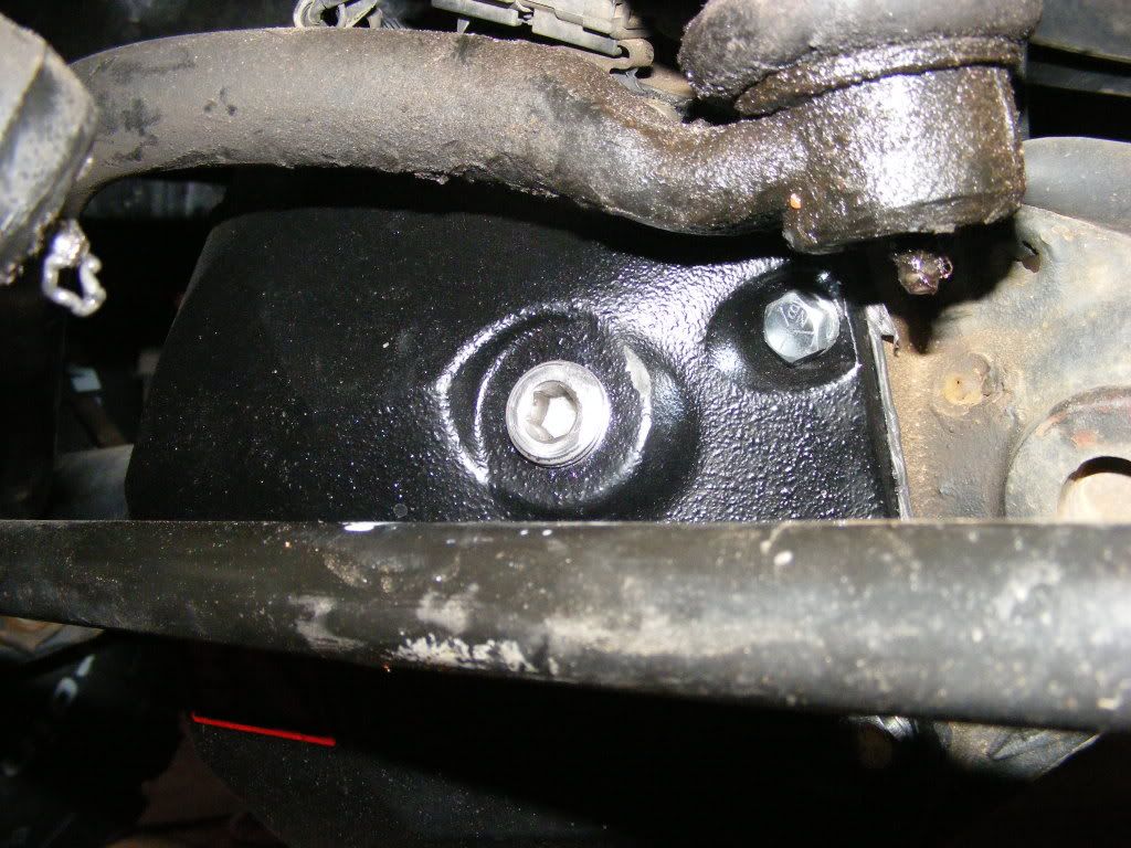

This is where my TB is hitting my Ridler diff cover with no susprnsion lift and stock bumpstops. This was happening while driving around town, not wheelin! Guess I'll be switching to a different cover It's hitting the cover and the fill plug.

Took a grinder to the diff cover and the backside of the trackbar, but it still hit. Ended up putting the oem cover back on. I bought a "diff guard" for the front oem cover, but I haven't bothered to put it on.

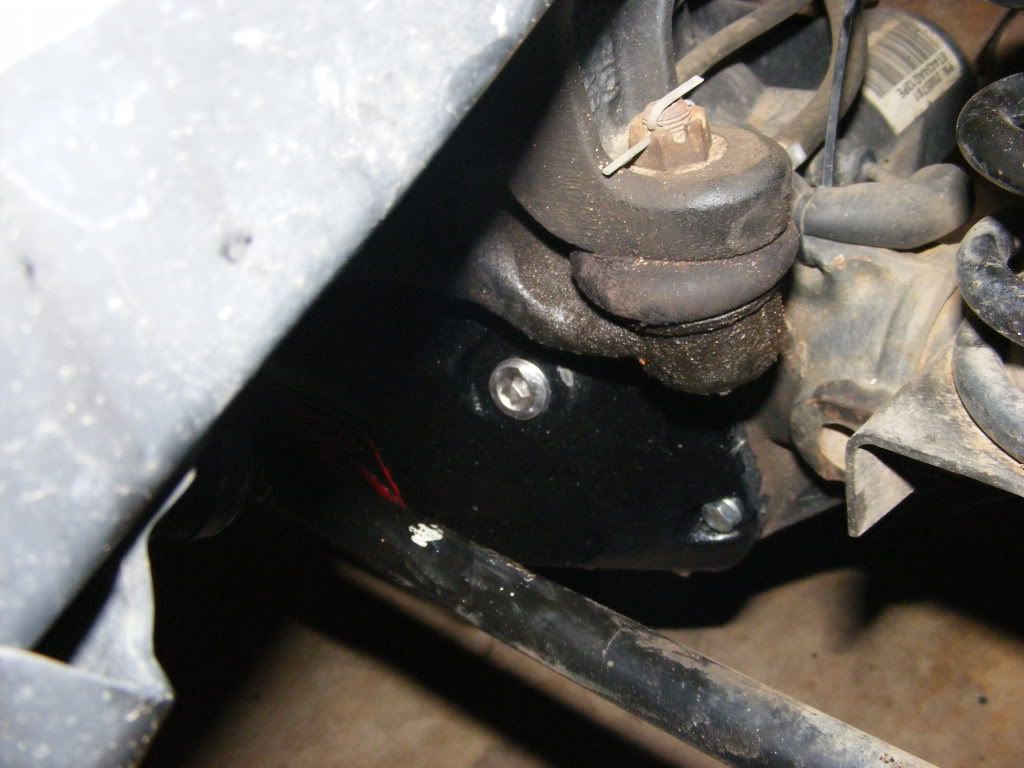

I didn't think I had problems before but I removed the springs today and the adjustable trackbar (unknown brand) I have it's at about 3" bumpstop when it hits the stock d30 diffcover. Which leaves a couple inches on the shocks.
The heim has just worn out from hitting the cover. So I'll check craigslist for a stock one while I brainstorm an idea for a new frame tb mount.
