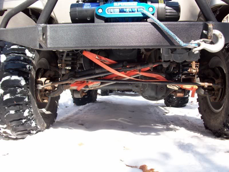

Ill Play
Pics of my Currie/JKS bar. You will notice in the Pic a rub on the Diff Cover. This was from my Currie/JKS TB. This was with OME ZJ springs and standard shocks, stocks arms and no extra BS.
I now have the FT Ultimate kit with their TB on. They call for 2" bump stops.
The parts from FT
I now have this TB on and it contact the ribs on the dif cover, with less than 2" of BS. I did quite a bit of testing and adjusting on LCAs to get the least contact longest arms.....
Second shot
Current suspension setup. Ft 4" springs, Adjustable CAs not much longer than stock, because of TB contact issues. Fox shocks with 1" additional BS over stock. This is because of the shock and TB issues.
The mount hits the ribs on the diff cover with no extra BS. I modified the cover a bit to add some clearance. I am also thinking I will modify the bracket similar to the clayton bracket. Cut off the joint mount and move it forward about a inch. Then my clearance issues should go away. But currently have the 1" BS.
Looking at these pics again I may need to put on the drop pitman arm. Thinking they are suppose to be more parallel, I dont recall where the suspension was in travel in this pic. I dont have any steering issues, like bump-steer like I would think would show up.
I am thinking I will try and get this done this weekend. Then I will go back to my OME ZJ springs, or possibly even the stock springs.
any way, my stuff. I do like the FT TB setup better than the JKS/Currie one. I get less flex, the cross bar I think is a great addition, especially since I have 37s.

Originally Posted by nriver View Post
Ill Play
great we need more input
that seems to be whats going on with a lot of people..
by standard shocks you mean the 22.5" long OME that don't need any bump stops?
how far forward is the ft track bar compared to the stock?
I can see the ft relocation bracket mounts to the frame about 6 1/2" forward of the stock mount and angles back to the rear...
this is the kind of info I think might create a solution to the problems an allow problem free operation for the 2" with short shocks and stock bump stops, not all the hollow tubed track bars can be bent much as knucklehead did for clearance issues without a proper bender, some of them are pretty thin wall....
I agree, the Pittman and track bar end doesn't move with travel, they are both mounted to the frame. the pic could be at enough of an angle tho to create an illusion of being at different heights... there would be minimal bump steer, prolly something so easy to get used to we just don't notice.
I don't think the stock springs would serve very well for down travel. they'll be unseating from over extension of the longer shocks.. the OME springs should be very close to the same length as the 4" ft springs unspung. I do like what you've done on your tJ...
no doubt. the ft set up will also help prevent the frame mount from getting torn off of the frame from a track bar that won't bend easily, I had a re HD that bent and tore off the frame mount. that's the reason I looked into Nth Degree and got the frame brace.
