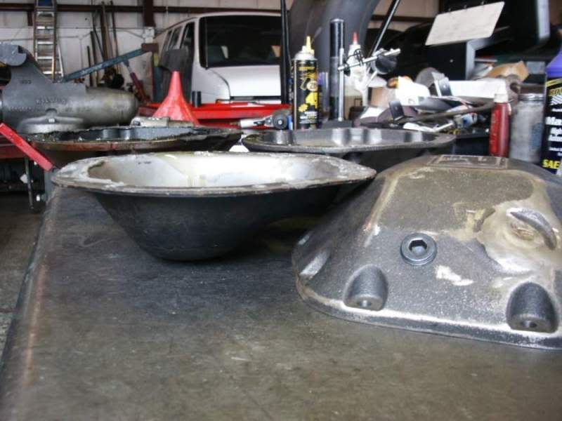

the covers...
stock, riddler, and crane..

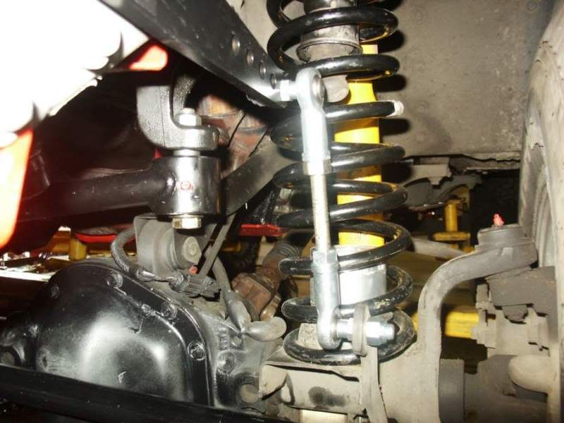

bumpstop extensions belong on the axle pad... like these stackable JKS bumpstops. on the rubicons, I drill and tap the pad since a self tapper will self destruct before it starts...

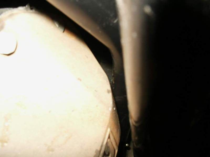

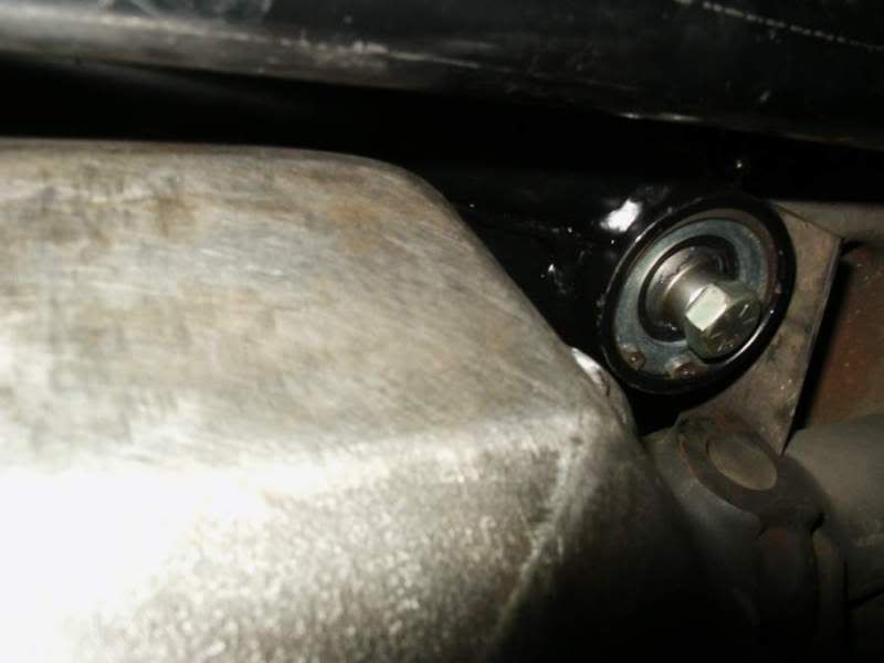

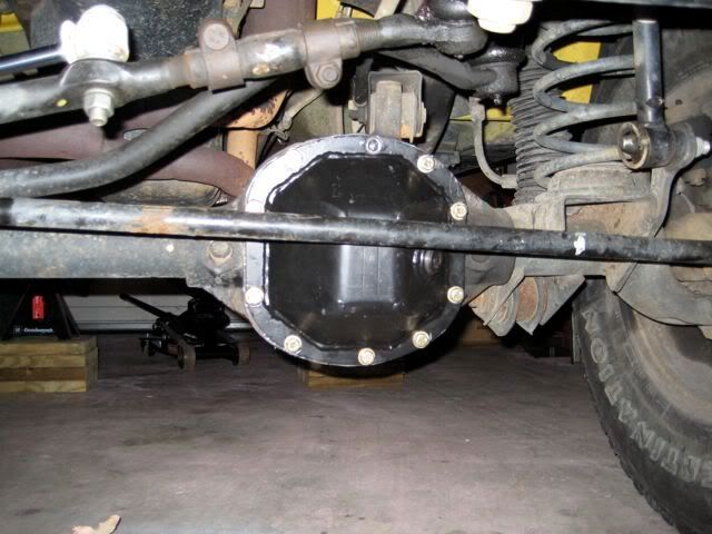

the stock track bar...
stock cover, sitting on the stock stops.. yep, it clears!
stock track bar and the Crane... I didn't even bother putting the riddler back on after this one..
Crane cover, stock track bar with 2" bumpstops.. that's close!

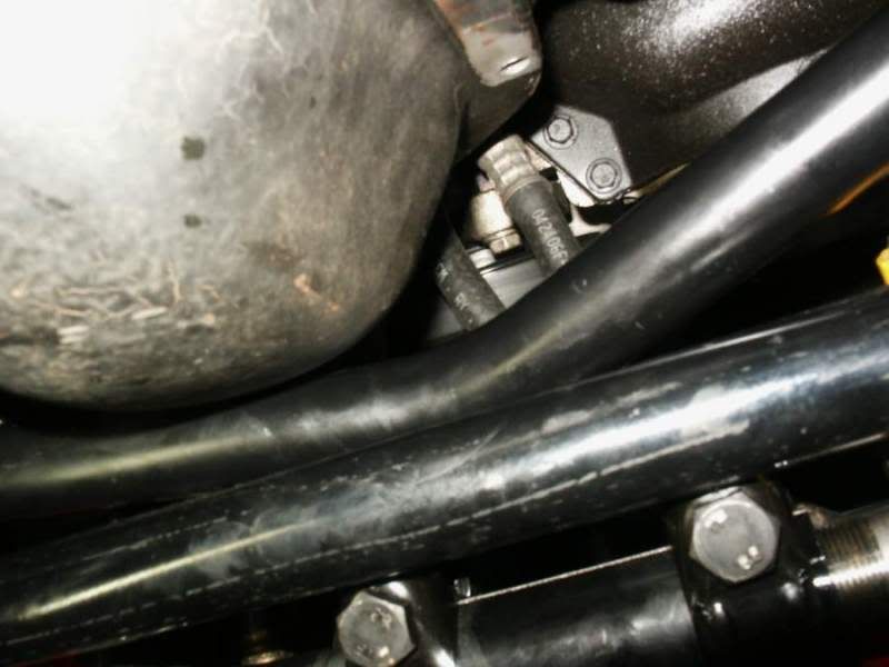

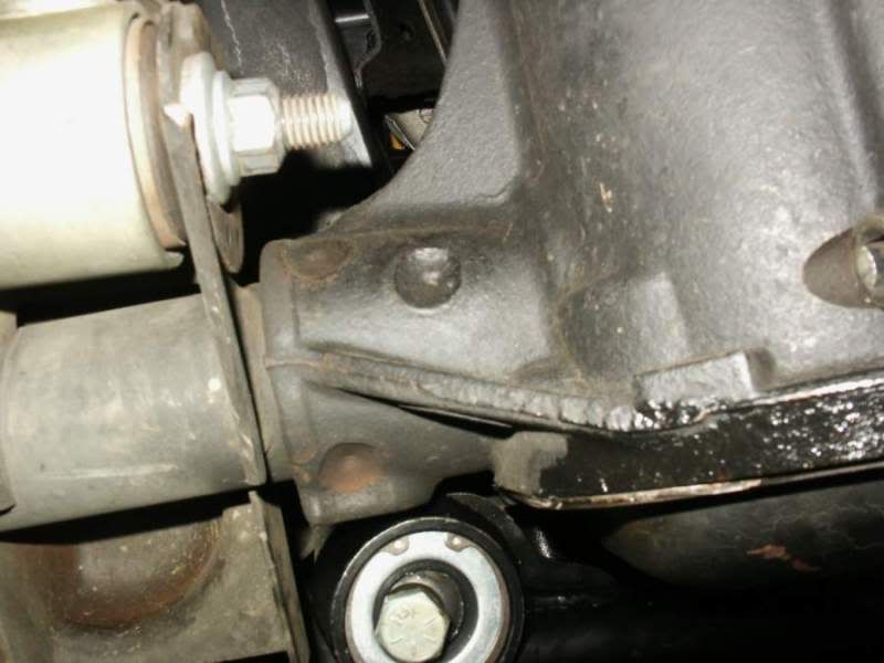

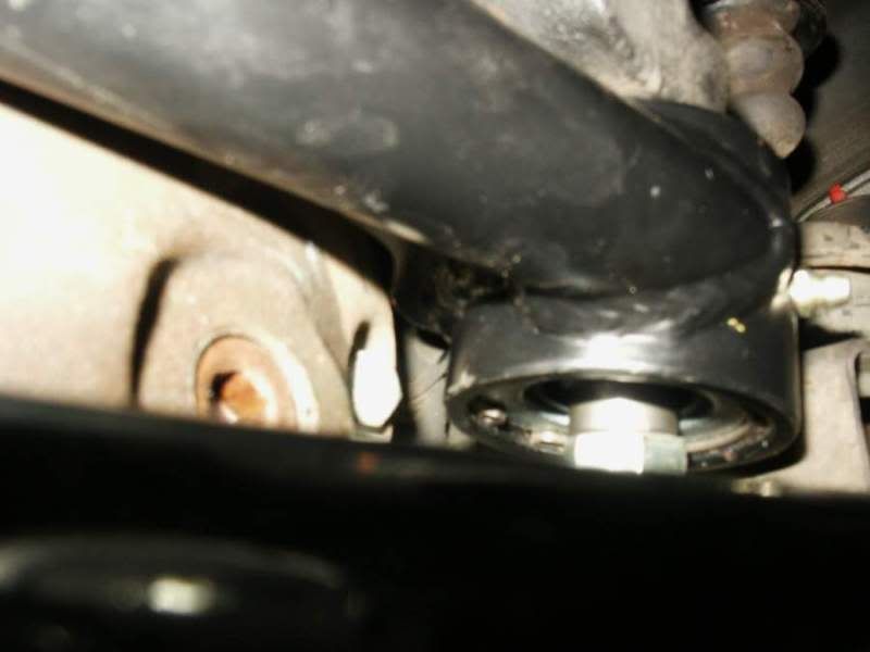

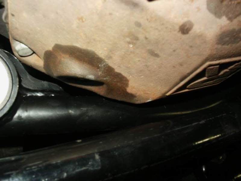

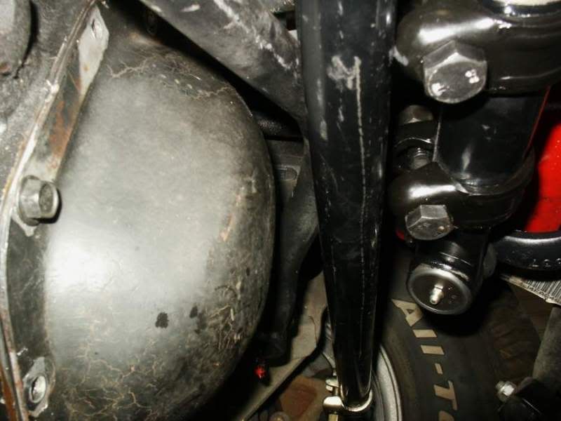

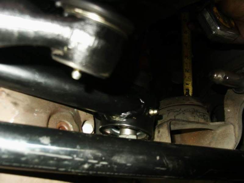

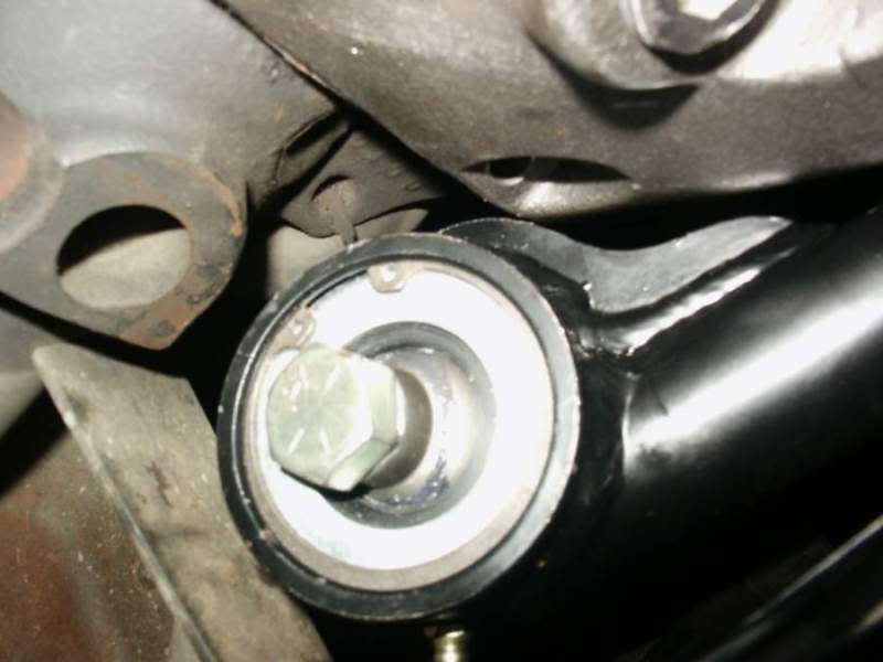

Currie....
first off, there's very little clearance for the JJ and the axle with stock length lower control arms..
this is the Currie smakin the stock cover... notice the scrape mark, it does drop to the amount a 1.25" bumptop will stop the uptravel but is being flexed pretty good. the Currie bar needs 2" bumpstops to clear.
Currie vs. crane...
the crane could prolly survive with 2.75" bumstops extensions but is to close for comfort.
Currie vs, riddler...
ya... that's 3" for the riddler cover touching the Currie track bar..
bottom line is 2" bumpstop extensions work for the stock cover and the Currie track bar.
3" at least, for both the crane and riddler covers, which could work with a 5.5" lift due to the shock length.
anyone see the reason I'm also saying the high steer is out the window also from looking at the pics?
the tie rod can't pass by the track bar without binding on it..
I'm running a nth degree track bar system, and have WJ grand cherokee flipped steering links... they pass by one another but are very close.
rubirock has a small JJ type bds track bar and high steer, i'm curious now if it can scrub or hit hard, he's also running a crusher? cover and I know it has 2" bumpstops.. I'll see If I can talk him into letting me pull the front springs just for kicks and concrete info...
