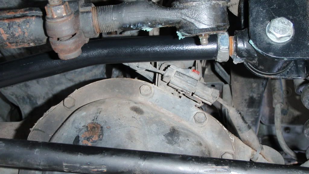

You might want to test that with the 4" lift as well. The track bar (pn 1085) that came with my 4" x-series (bought 2 months ago) hits my diff cover pretty bad even after I shortened the lower arms to near stock length.
Just installed a Series II 4" with the older style adj tracbar. The track bar hit the diff cover, so I talked to RC and they said it was "imposable". There must be something with my suspension. They sent me the new style bar after I suggested it might work. No rubbing no problems, now. I had to have the bracket welded too.
Before

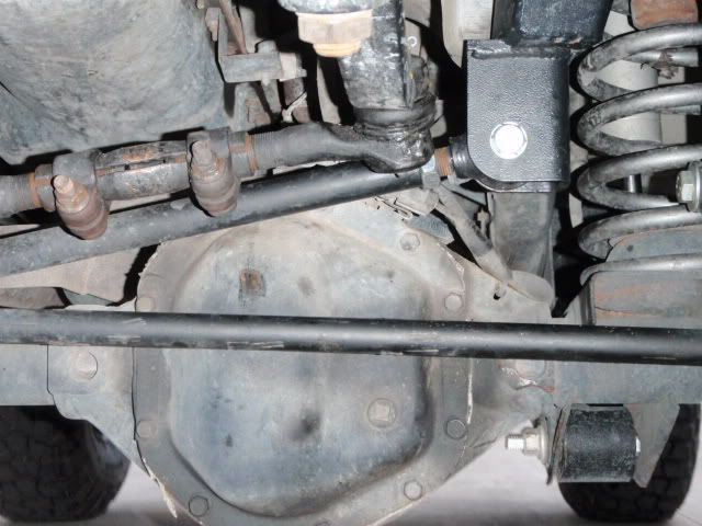

Yep, Porta band'd it right off. Then Grinded it, then sawazalled, then grinded, then porta banded, then grinded......... You get the picture. It took me longer than I thought it would.
I am in the middle of a SA/MA/LA build. Cant quite decide what to do with the arms. I knew the TB was in the way. I tried the Currie I had and the FT TB and they kept hitting running 1" of BS. So, I ordered some stuff up and cut the old mount off.
It looks like I can run a straight TB from my new mount. At least my mockup bar looks like it will work.
One of these days I will learn something about suspensions or taking other peoples advice. I just like to do it my way. LOL.
It looks like this now.

Yep, I ran into all those issues, prob spent more time. Kept trying to use the stock mount with different attachment methods. Things kept hitting, so I cut it off.
So, building my own TB was the only answer. Not that I really know how to build one.
