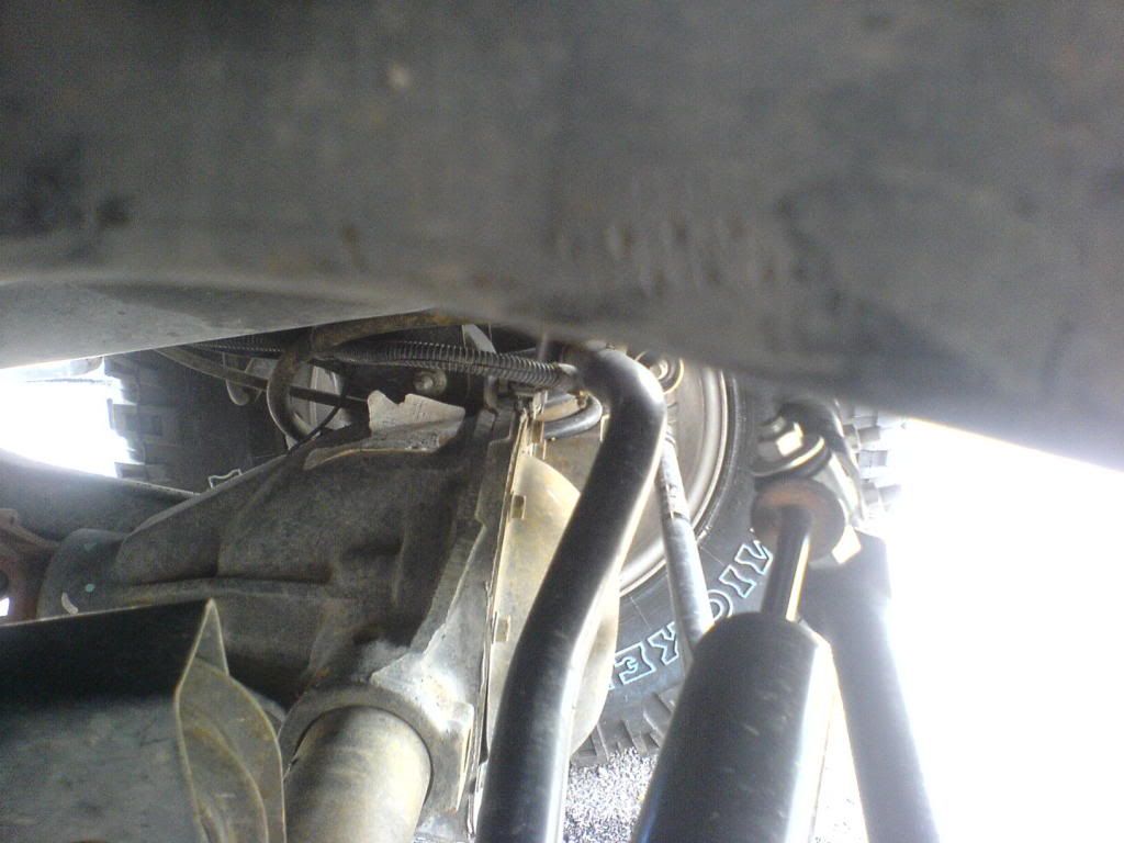

got my currie hd tb today(p# js 9120)its great but not the new offset one i wanted, but will be fine for many years im sure..i may reweld it if ever the need but it clears real well..it isnt flexed in these pics but can tell from the old one its fine..
so if any you guys order one dont use this part # if your wanting the offset welded one..
if anyone knows..does the axle end bolt hole need drilled also?i drilled the frame bracket for 5/8 and worked fine but the axle end says use original bolt?but the original bolt is a bit loose in the new tb axle end?
they should make it to accept a bigger bolt there also since now thats the new weak point i would think,john
johnny9 is offline

a lot..if not all currie products are made by jks,for currie..i think currie comes up with a better idea from time to time and has jks make them there parts to put the currie name on it..even tho currie seems a bit cheaper in price than jks..
my new tb didnt come w/a greasable bolt that i thought it did and does not have a grease fitting on it no where..
first time it comes off i will drill the j joint for a zerk fitting like the ones ive seen here in pics,john

Posts: 5,999
they should make it to accept a bigger bolt there also since now thats the new weak point i would think,john[IMG]http://i680.photobucket.com/albums/vv168/gatepeddler/DSC01909.jpg[/IMG
[IMG]http://i680.photobucket.com/albums/vv168/gatepeddler/DSC01911.jpg[/IMG
[IMGhttp://i680.photobucket.com/albums/vv168/gatepeddler/DSC01912.jpg[/IMG]
yep that's one thing that bugs me about the jks bars is the bushing size and using the stock bolt.... it's ok tho, it's double shear.
Originally Posted by CB3 View Post
Say, Mudb8, how similar is this Currie HD trackbar he's showing in his post to the JKS bar I already have? It looks similar. Is is the same trackbar? Same shape bend around diff cover?
It looks the same other than the bolt size and the offset coping, that's why I figure I could reweld and brace your current jks track bar instead of getting a new one from currie...
dang, you can also get a new JJ banjo bolt from currie instead of drilling the case.

[QUOTE=mudb8;7434345]yep that's one thing that bugs me about the jks bars is the bushing size and using the stock bolt.... it's ok tho, it's double shear.
i asked them and i thought they said it came with one but i must have misunderstood them..oh well,this bolt should never break..
the stock axle bolt end just has a 1/8 inch slop in the bushing they sent,,like its a little bigger than the stock bolt..im gonna see today if the stock steel sleeve will fit the new bushing,or get a fraction bigger bolt.
you cant tell when driveing it tho...yet,john

[QUOTE=jayr;7435265]I was under the impression the tb in post #109 by Kiwi on the page below was the new Currie HD tb part # JS9120 but please correct me if I am wrong...
i was under the same impresion but this is what i got..i just flexed it out the best i could in my yard and theres more than enough clearance..im pleased with it, and if needed some day i will cut and reweld the joint on a offset but not necesary for me yet..
when money allows i will get the hole front steering set up,john
