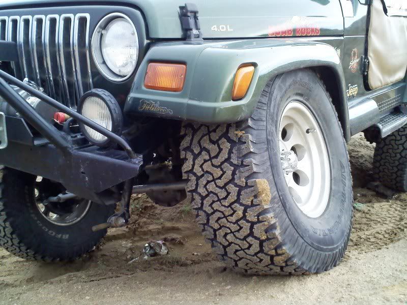

and the verdict is...
It's clears by a pretty good amount.
I have a 4in RC lift, 33's, with stock bumpstops, these pics were taken at the same time. I'm just about at full drop on the other side, and you can see my tire is pushing up on my flare on this side.
[IMG]http://i50.photobucket.com/albums/f331/bmxrules39/Jeep/jeeptbtestclearance.jpg[/IM
the pics look flexed.. when both bumpstops hit at the same time is when you have a problem, having one side stuffed and the other side drooped makes more room.. for example if you hit a speed bump dead on with both tires, the track bar is gonna hit the cover if there's not enough clearance..
hook the winch to the front axle and pull it down to the bumptops or to the point the shocks bottom out.. hopefully your still good..
the shocks for the rc 4" lift are also 26" long, which need a little more than 2" bumpstops up front to prevent them from bottoming out..
thanks for the input and pics...
