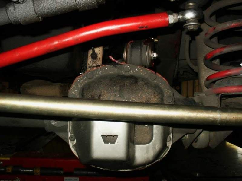

heres another one... the caster was set at 3 degrees with 16 1/4" long lca's, I reset it to 7 degrees using adjustable uppers, still hits
it also had proplerly set bumpstops.
skyjacker adjustable track bar and d30 on a 4" lift
