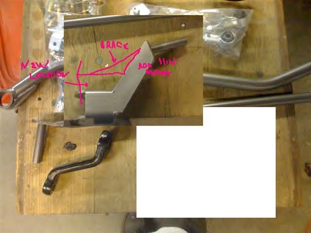

So, I did modify my TB mount today. I am to tired to take pics, but I did add a second sheer point to the front of the FT mount. If it does not work I can always go back to they way they designed it. I also moved teh TB mount up by about a inch. Thinking this would help with the diff contact.
It looks something like this.
At the end of the day it rides good, no bump steer.... Took it around the block.
I do need to figure out how to bend the bar back about a inch. There is some stress between the frame mount and the diff mount. That or re mount the frame mount at a 5 degree angle, something like that.
I have gone full cycle with the suspension with no contact.
I also lost my frame brace, as it sits there would be some contact. Thinking I could resolve this issue, just tired of being on my back under the jeep.
Not sure this is my long term solution.
