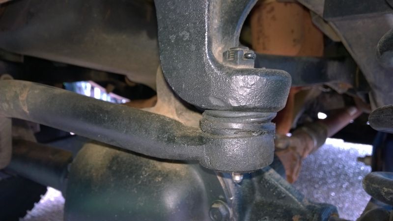

I recently purchased an 06 TJ that had a few problems (brakes which have been fixed and the front track bar). I replaced it with a MOOG but I'm getting a knock when I turn the wheel. I looked at it and the frame end is moving. I'm guessing the hole got wallowed out. What is the best way to fix this? I only have a 2" spring spacer lift and I'm afraid if I get an adjustable MC or JKS that require a bigger hole they will be too long for this lift. Thanks for any help!

Are you certain it's the hole wallowed out and not just a bad joint on the track bar? Does the crown nut visually move, or just the lower portion of the joint? They are a tapered fit, so while not impossible, it's unlikely that the bracket wallowed out unless someone removed the cotter pin and loosened the track bar at one time than never replaced the cotter pin after tightening allowing the crown not to somehow back off.
Was the track bar you removed stock, or adjustable? If it was aftermarket adjustable there is a good chance they drilled out the taper for a 9/16"-5/8" bolt.
The jks 126 will adjust short enough for a 2" bb. You will need 2" bumpstop extension for tie rod to track bar clearance if you don't also add a v8 zj tie rid. You than need 1" for tie rod to track bar clearance. You may still need more bumpstop extension for other parameters and should always check clearances.

It really does not matter if the hole is wallowed out. Clamping forces hold it, not the bolt and hole. It is not a hitch pin. The bolt has to be loose to wallow out the hole.
