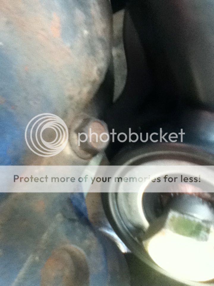

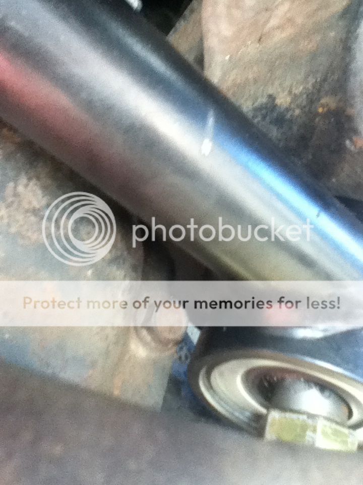

I just installed the Currie TJJ since my frame mount was already drilled out. When checking at full bump, the gusset on the frame side of the trac bar contacted a bolt on the stock diff cover, requiring 3" of bumpstop ext. Has anyone else had this problem? I have OME TJ Heavy springs up front with a winch, steel cable and plate, which brings the front back down a bit. I'm contemplating wether adding a 1" coil spacer, and then adjusting the trac bar out to recenter the axle, will allow that gusset to clear the diff bolt. Either that or I'll just grind it down a little.
I'm guessing by heavy duty springs you mean OME 933's. Swap to OME 934 springs in front, you won't need a spacer. It's a higher rate & longer coil. Also, take a silver sharpie marker, and outline the offending area on the gusset and grind it down.
That should solve most of the issues. You'll probably find a new limting factor, but if you can get down to ~1-1.5" bumpstop extension with that setup you're doing just fine. With a 1.25" BL, that'll clear 33s.

post #1620 of 1785 Old 09-23-2013, 07:38 PM
jermeyg
Location: Rosamond
Posts: 557
Another option if you have adjustable control arms is to shorten them up about 1/4" and see how it clears. What unlimited04 suggested is a good option as well.
