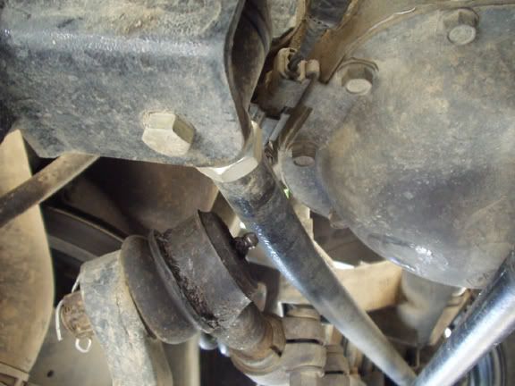

Got some pics of where its hitting... do you think it will start messing up the diff? what is the best way to fix?
it's more likely to cause the frame end joint/threads to fail than mess up the diff cover..
I'm assuming fro the looks of it, thats a rc track bar?
looking at the pic, you have planty of adjustment there, I'd pull the bar and put it in a press or tube bender and bend it slightly at the contact point and at the axle mount end, then re adjust it for center. be sure not to bend it very much, you'll run outta adjustment, bending it makes it shorter.
if that doesn't work, the NEW HD currie track bar seems to be the one that's definately not gonna hit anything...
