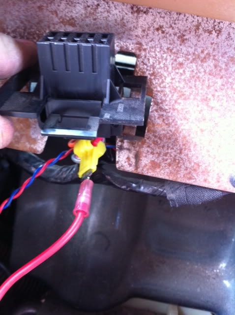

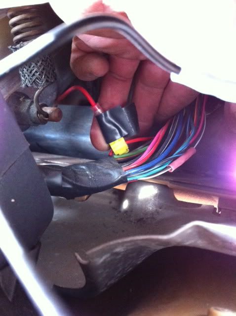

So I called my local Jeep dealer and talked with service. After explaining my situation with the them I was told that its not likely to be the PCM being that when I hooked up the scan tool I was given an accurate temperature reading. He told me it was most likely the gauge or a worn wire. So I tore my dash apart and took out the cluster. Behind the cluster I found a wire that had been directly wired into one of the main connectors to the back of the cluster and the wire ran to another wire located on the main wiring harness connecting to the steering column.... WTF. The wire that is tapped into for the gauge cluster is Red with a grey stripe and it is wired into the main steering column wiring harness to a solid Red wire. Any ideas what those wires are, and why they have been connected to each other??
Also, this Jeep at one time had an alarm hooked up. As far as I know this alarm was taken out and just the little indicator lights remain, which are not plugged into anything. Sigh... hope I didn't just buy an electrical nightmare.
A little more information on my rig: I have also noticed that I cannot have both my driving lights and fog lights working at the same time. Meaning that when I have them both connected there is a relay behind the glove box that starts making all sorts of noise, if I unplug the relay then the noise stops (duh) and then I lose my fog lights but the driving lights are okay. There are two relays behind the glove box that look the exact same and are hooked to each other...its the one on the left that makes the noise. What a can of worms.
"Good judgement comes from experience, and a lot of that comes from bad judgement" -Will Rogers
Codioos is offline
post #11 of 13 Old 06-30-2011, 05:45 PM Thread Starter
Codioos
Location: Spokane
Posts: 11
Instrument gauge harness
Steering column harness
