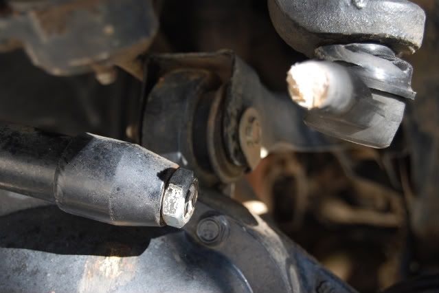

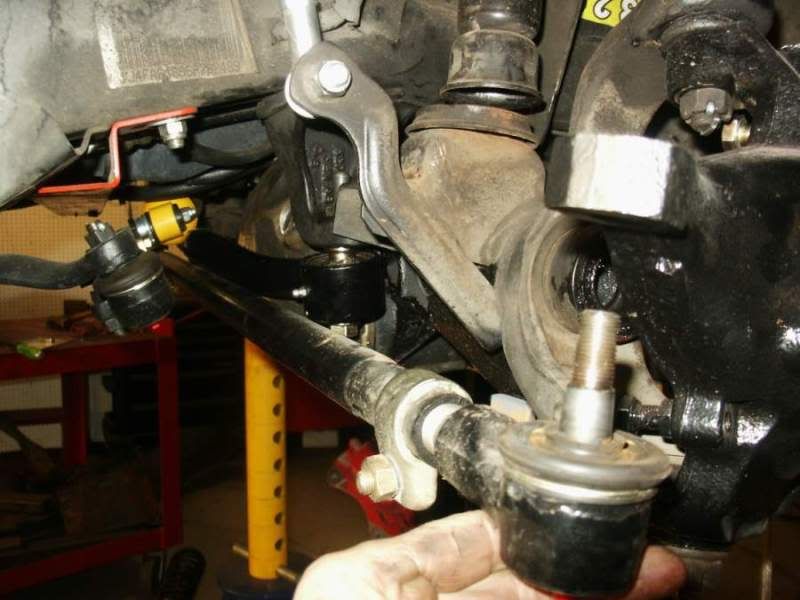

old style JKS doesn't clear the stock diff cover...needs 2" front bumpstops.
new style JKS doesn't clear the tie-rod...needs 2" front bumpstops.
for reference, nothing straight clears the diff either.

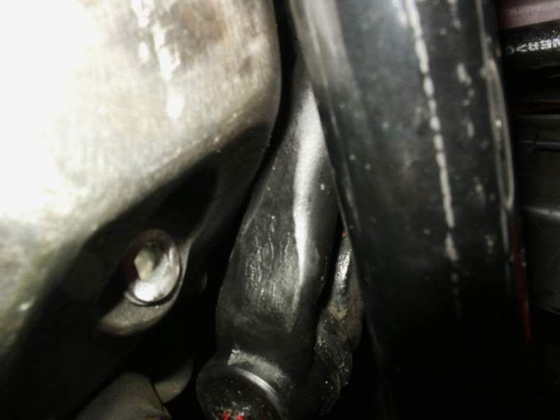

diff cover vs tie-rod gives this:
you need to get rid of the Riddler covers...they suck from a clearance standpoint. great company, great quality, terrible design (for a TJ at least). look into a bolt on Warn, Rugged Ridge or Barnett/T&J diff cover...
