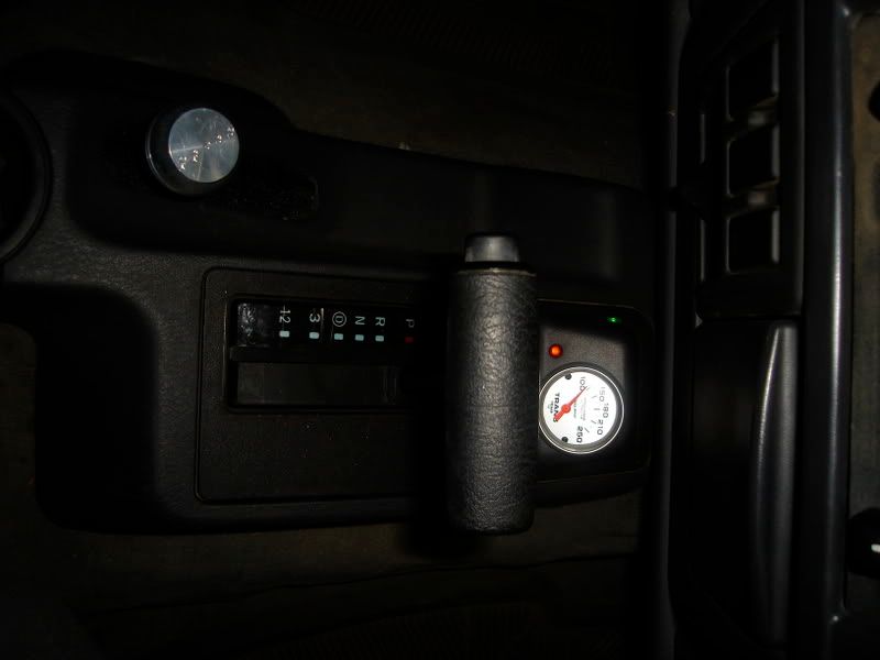

here is mine in 2 hi all the way forward is 2 lo. i rigged it so the cane is short. only the knob sticks out when in 2 hi.
