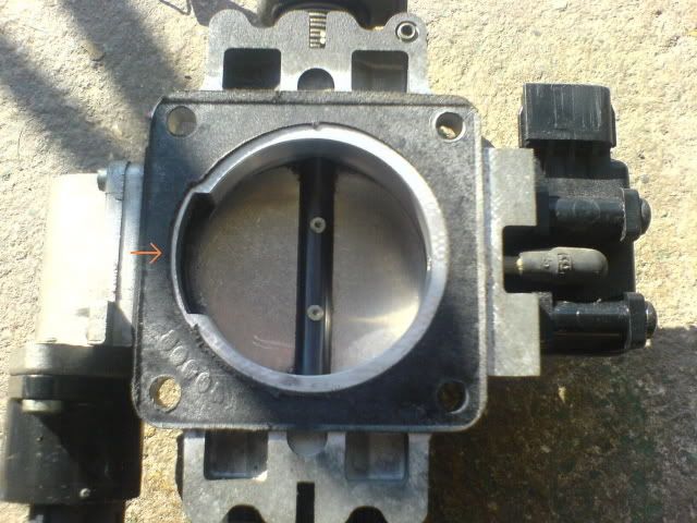

Well I ordered a 62mm throttle body and was talking to the guy about the dreaded whistle with what I have now. He said that the gasket is usually the cause of the problem. So this morning I went out and pulled it apart. Sure enough my gasket had been sticking out into the throttle body by about a 1/16 to1/8 of an inch. Now I do have a Helix spacer on, but that gasket was back far enough to not cause a problem. So after putting everything back together, it was time to test it out. What do you know it actually worked. If I really listen, I can here yet a faint PFFT sound. I do have a K&N intake on it, and you can still here the vacuum sucking sound from that. But the whistle I was getting around 2,300-2,400 RPM is gone.
Here's a pic of where I cut.
Don't know if this will help anyone else out, but it helped out in my case.

Used the search engine. Once again another 5 year old thread. Anyway, I figured I'd revive this incase anyone had any other ideas in the past few years on what the problem might be. I tried this method on my bored tb with no luck. Same annoying whistle. I've ground down every sharp edge, sealed everything on the tb and no progress. I knew I should have kept everything stock.

It has very little better throttle response. That's about all they do. Oh, they whistle too. I noticed that I had a little smoother idle too, but I probably would have gotten that if I had cleaned my old one. I found lots of people claiming how great they were so I didn't even bother with my old one, I just got a bored one. Biggest PITA. All it likes to do is whistle. I'm currently looking for a stock one to put back on and melt down the one that's bored out.
