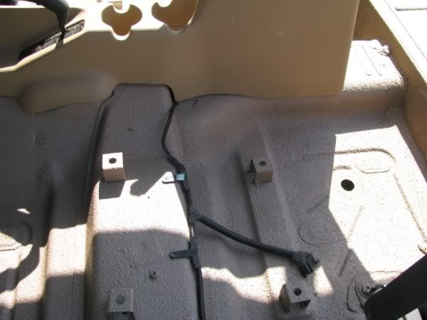

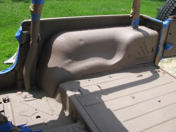

I started by tacking down the unistrut seat risers. When you unbolt the seat, they become a pain in the butt. They are permanent now.
At some point, something punctured through the rear passenger fender and right into the tub!
in
out (or in, depending on how you look at it)
I filled that with silicone and beat it down a bit and sprayed right over it.

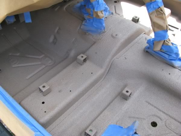

The tub I did the standard sand/scuff it down. Wire wheel on the rust, mask it off, ear plugs and rolled up paper towels in the boltholes.
I had already purchased the Satin Beige Mettalic (2008 GM Truck color, if you are wondering). Mixing is easy. Heres the stuff.
Don't crank down the quick connect on the gun or it will crack. Like this.
It worked fine, just leaked air right there and, with the latex gloves on, spraying left handed sounded like a herd of munchkins at a farting convention.
As you can see there is a measuring cup, for which the wife will never forgive me. You need to have a ten percent color base in your mix. It's a 1000ml bottle so that gives you 100ml of base, or about a half a cup. I went a little heavy on mine. Measure out a half cup of base and pour it in, fill it to the ring in the bottle with activator, cap it and shake it like it knows how to boo-gie. I timed it at about five minutes of shaking it. It seemed to mix it well so I'm going to go with that.
One bottle
Two bottle
Three bottle
At this time my compressor gave a last wheeze of death rattle and settled into the sweet here-after. Call Pop, Get a ride to Tractor Supply, buy 'nuther, back in bid'nes.

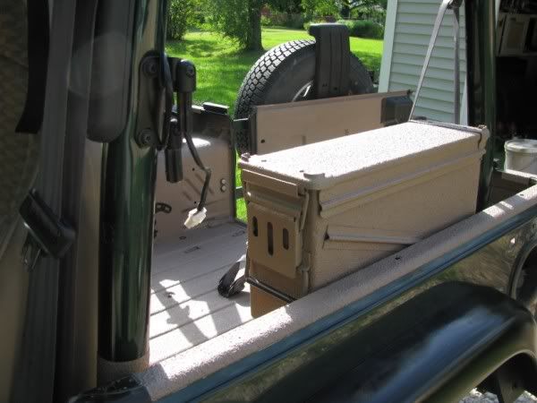

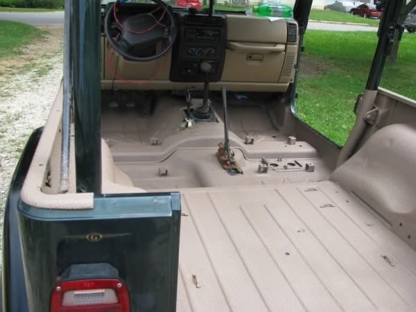

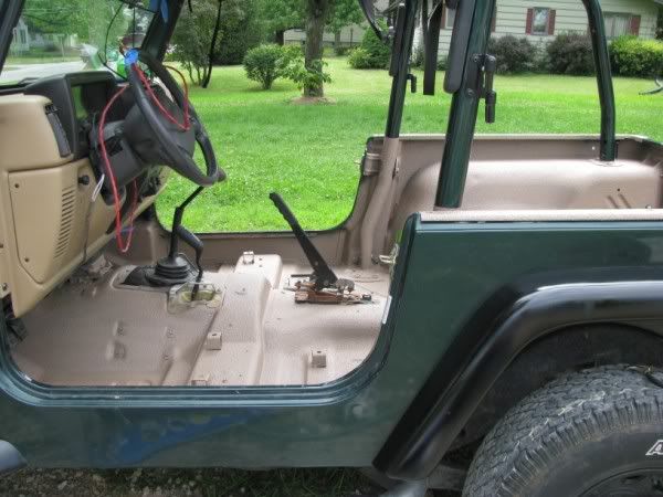

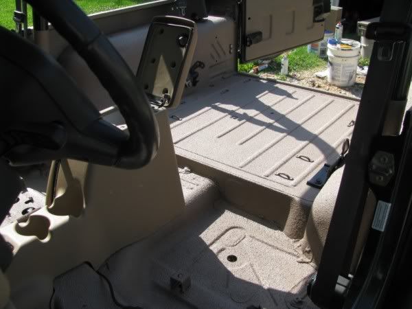

The fourth bottle was good for touching up misses and going back over the spots that were too light. I had just enough. Sprayed the ammo can with my strap and jumper cables and stuff too.
Here's the finished product with some Krylon Fusion thrown in for good measure
Sunday I put on the RC 3.25 and tires. Top gets here Monday. I'm all a-twitter

Great job-I painted mine last year and it is holding up perfect. It sure made me feel great when it was finished and looked as good as rhino/line-x and cost about $400 less.
If your on the fence about doing this-go for it. Once you have the seats out and prepped you have it licked-the actual painting dummy proof unless you get it on something you shouldn't have.....

...I'll be damned, uni-strut for seat risers. Great idea. Cheap, and tougher than nails.
Out of curiosity, which side was the entry on the mystery hole?
scavanau is offline   Reply With Quote
Old 07-27-2009, 07:24 AM   #13
bradthebard
The faux feather finish
bradthebard's Avatar
Location: alpha centari
Posts: 1,614
Passenger rear wheel well.

Entry, as in did something enter from the outside, or did something exit from the inside?
Old 07-28-2009, 06:51 AM   #15
bradthebard
Posts: 1,614
Something came in from the outside and poke-de-hole in the tub. The steel was folded into the interior of the Jeep and a little dimple was raised. Looks like somebody slid into a bit of rebar or something. It's too messy to be a bullethole.
