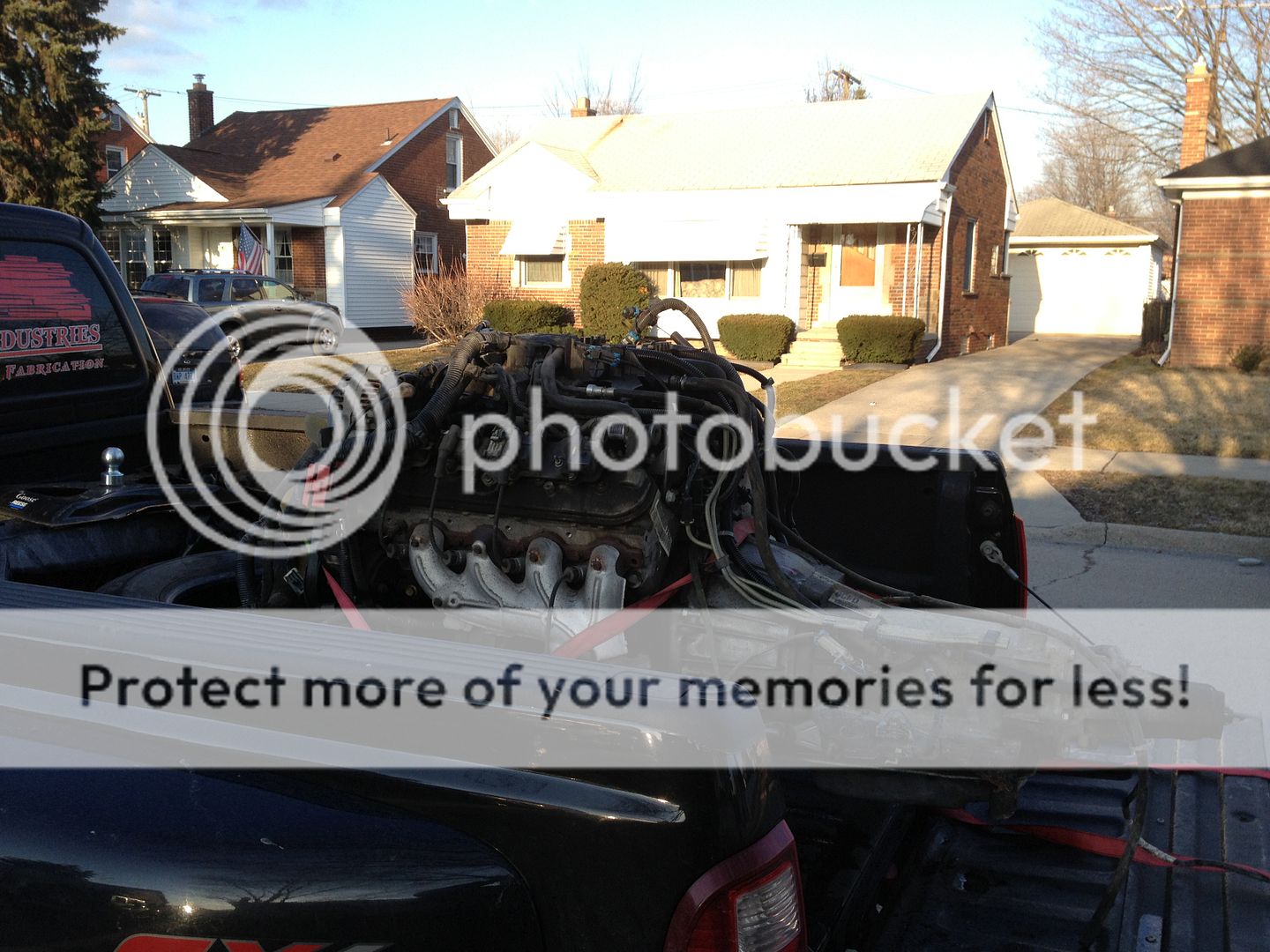

The other day I picked up a low mileage LM7/5.3 Gm LS Series motor, ecu, 4L60E trans and other random parts for a local yard. currently on the search for a gm 231c case to do the 231c/231j masterpiece.

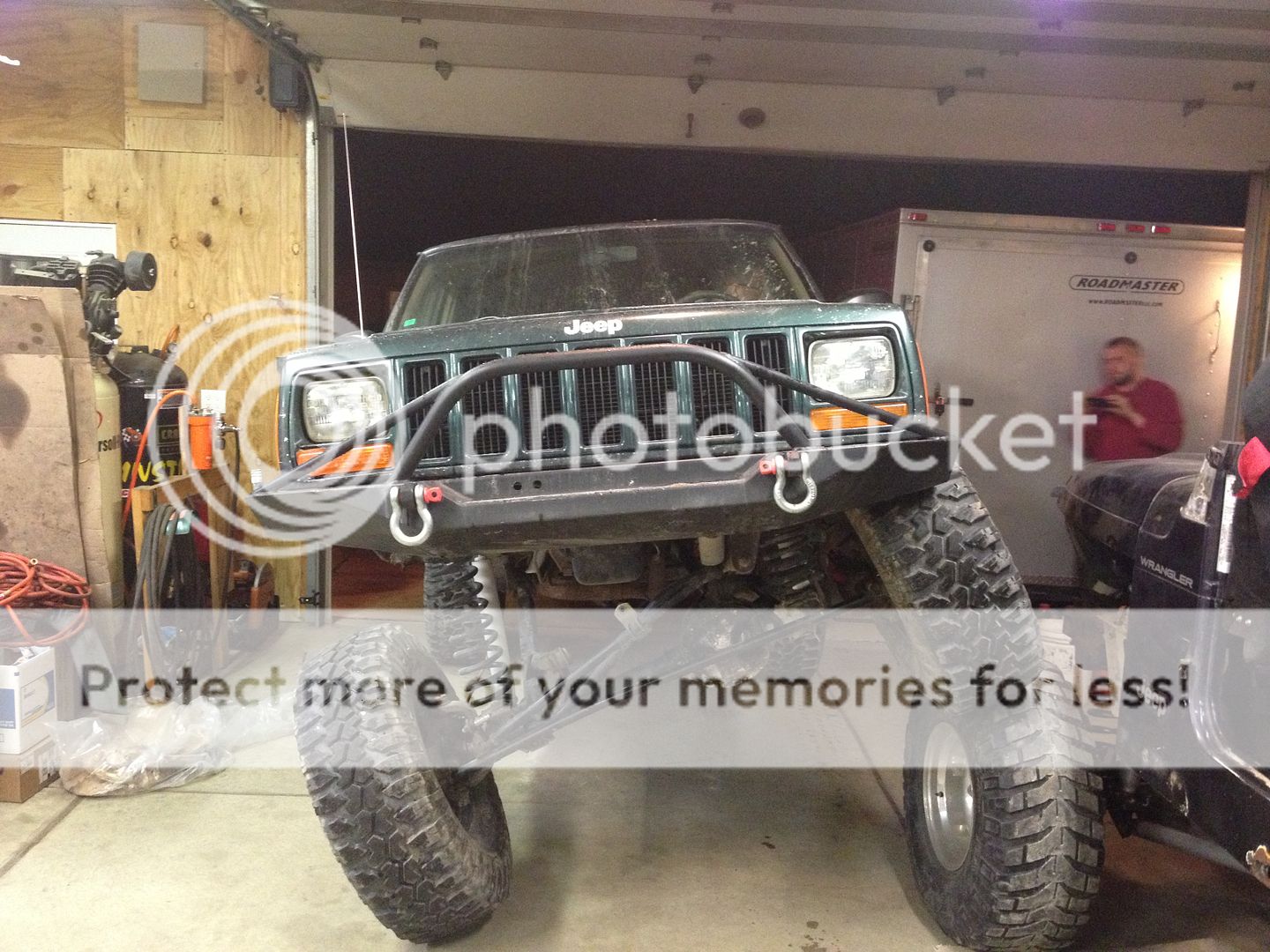

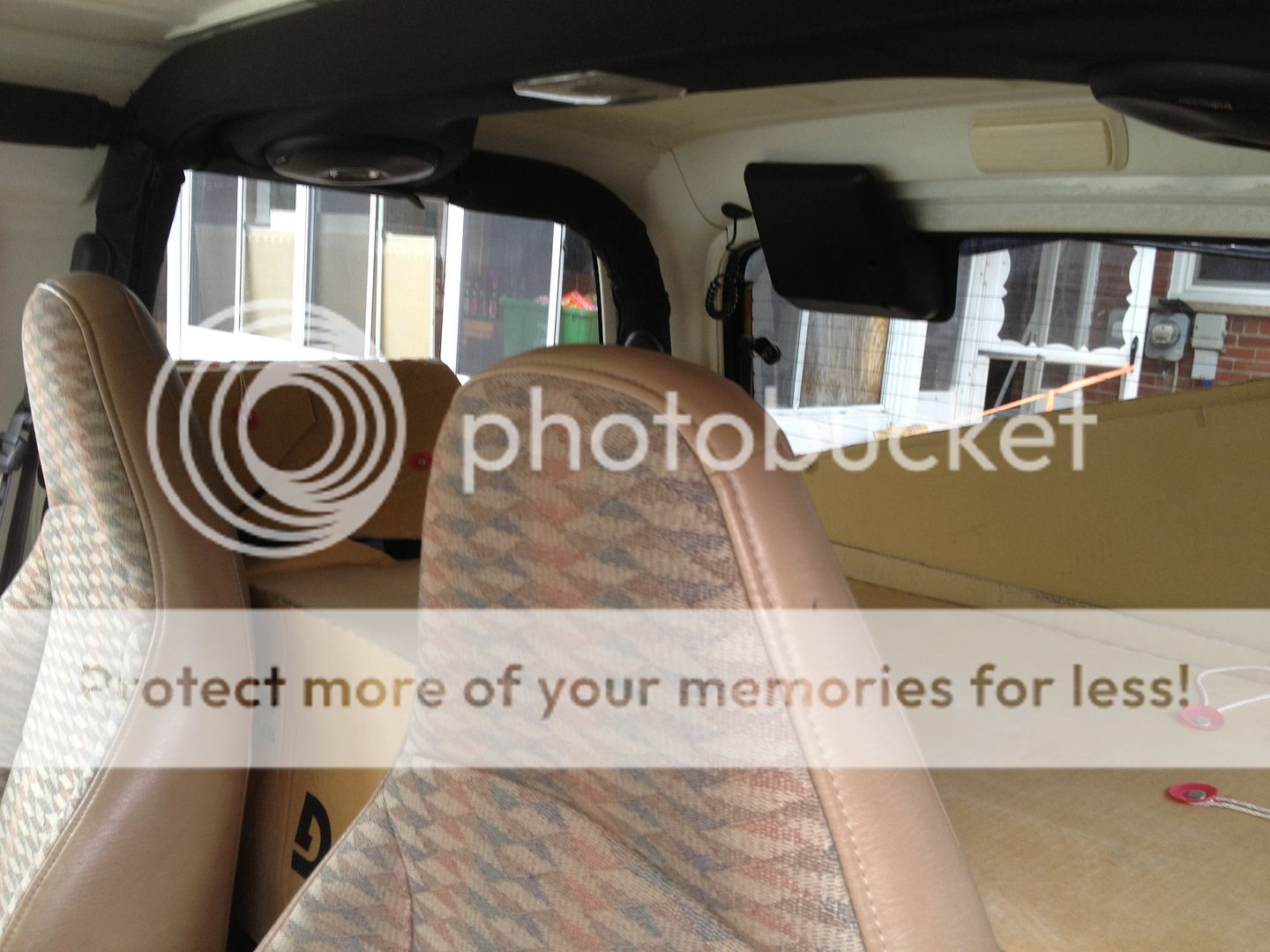

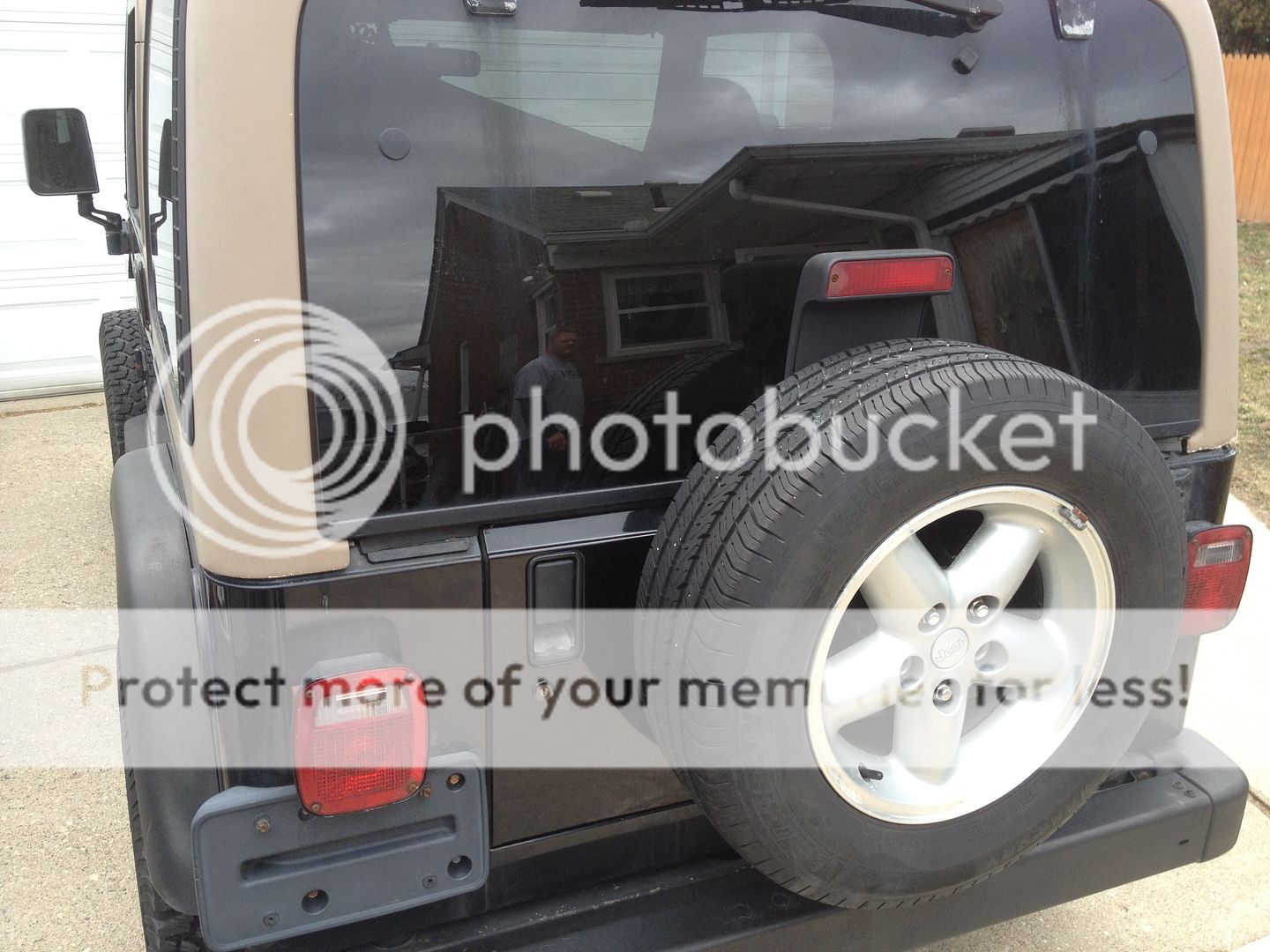

Ok we picked up the jeep this afternoon. We where racing the clock for a minute and I forgot to take pics.. WTF dumb@ss. Ill swing by my brothers and snap a few.
Ill fill this thread with tons of pics! Ill post links to photo bucket when I get a new library set up for it.

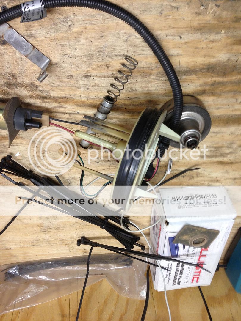

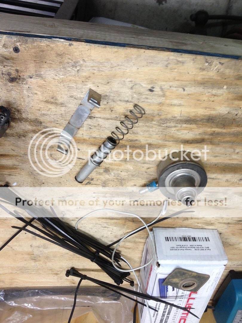

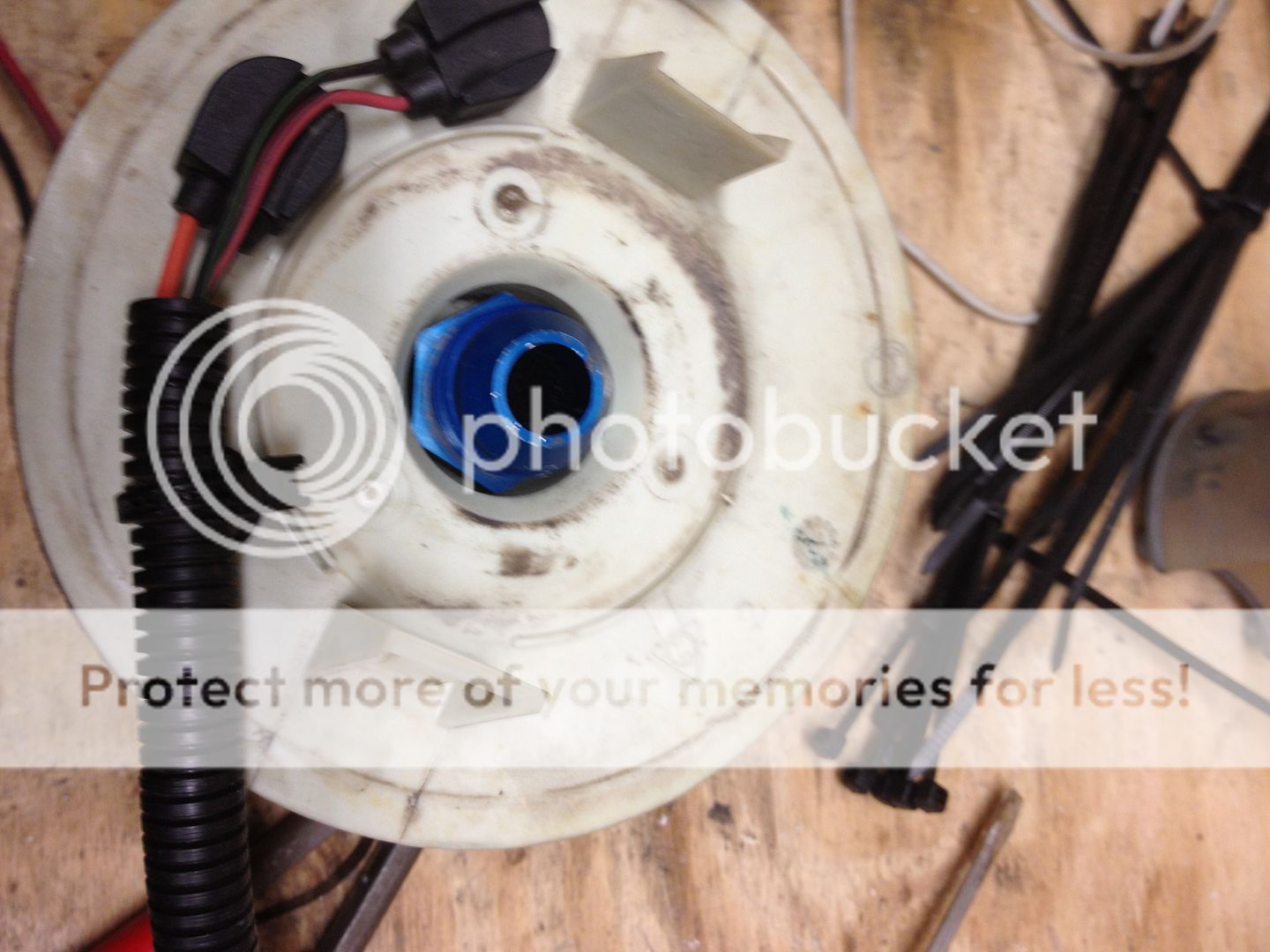

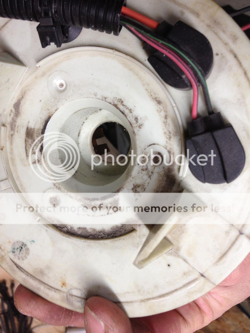

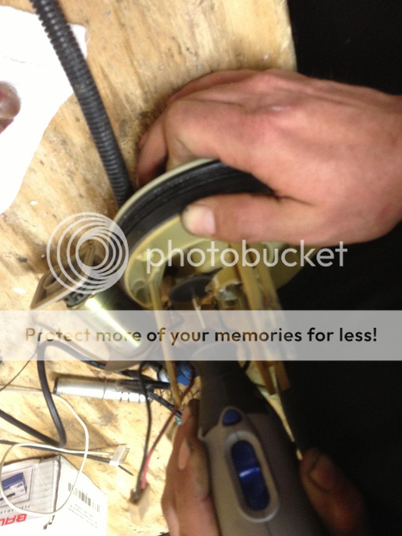

well i figured id get to messing with the fuel system tank plumbing seeing that we had an extra 97-04 fuel pump assembly floating around. I want to use the factory pump and loose the regulator and I don't want to buy a 180 kit to do it. so i have come up with 2 solutions. option 1 involves some an fittings, washers and RTV. option 2 involves my buddy and his new cnc lathe! both solutions should result in the ability to retain the stock fuel pump 'setup' meaning still have the 'tension spring and riser tube' in place and functioning. if neither pan out the way i want, then the 'fall back' is high pressure line between my fitting and the fuel pump.
I took the stock pump apart and broke it down into its components. Made sure I understood how it all 'worked.' the fuel pump connects to the steel riser tube and is sealed by a rubber grommet. the tube also acts as a tensioner, keeping the lower basket 'pushed' against the bottom of the tank. the upper portion of the riser tube slides onto the plastic shaft that is sealed to the 'regulator port' with an O ring. the shaft allows the riser to 'adjust to the depth of the tank.' the shaft is about 3/8" in diameter
I started to solve this project through option 1. option 1 will require about a few AN fittings to make. now the stock pressure regulator dumps fuel from ports around the shaft, which pours cold fuel on the fuel pump to keep it cool. to allow for this cooling feature. the basket holds fuel around the pump and dumps the excess once it is full, over the top edge into the tank. i have [2] solutions A-bulkhead fitting through plastic off to the side with line dropped back into 'basket' option B drop line directly down into the tank and drill a few holes in the basket to allow fuel to flow through and cool the pump as well. maybe ill drop the line down and plumb it into the side of the basket and replicate stock. either way i am trying to avoid aerating the fuel.
heres the regulator, tension spring and riser tube
heres the stock upper assembly. the riser slides on the plastic shaft. the unused fuel pours back into the tank at the area of the top of the shaft where it changes to about 1" in diameter.

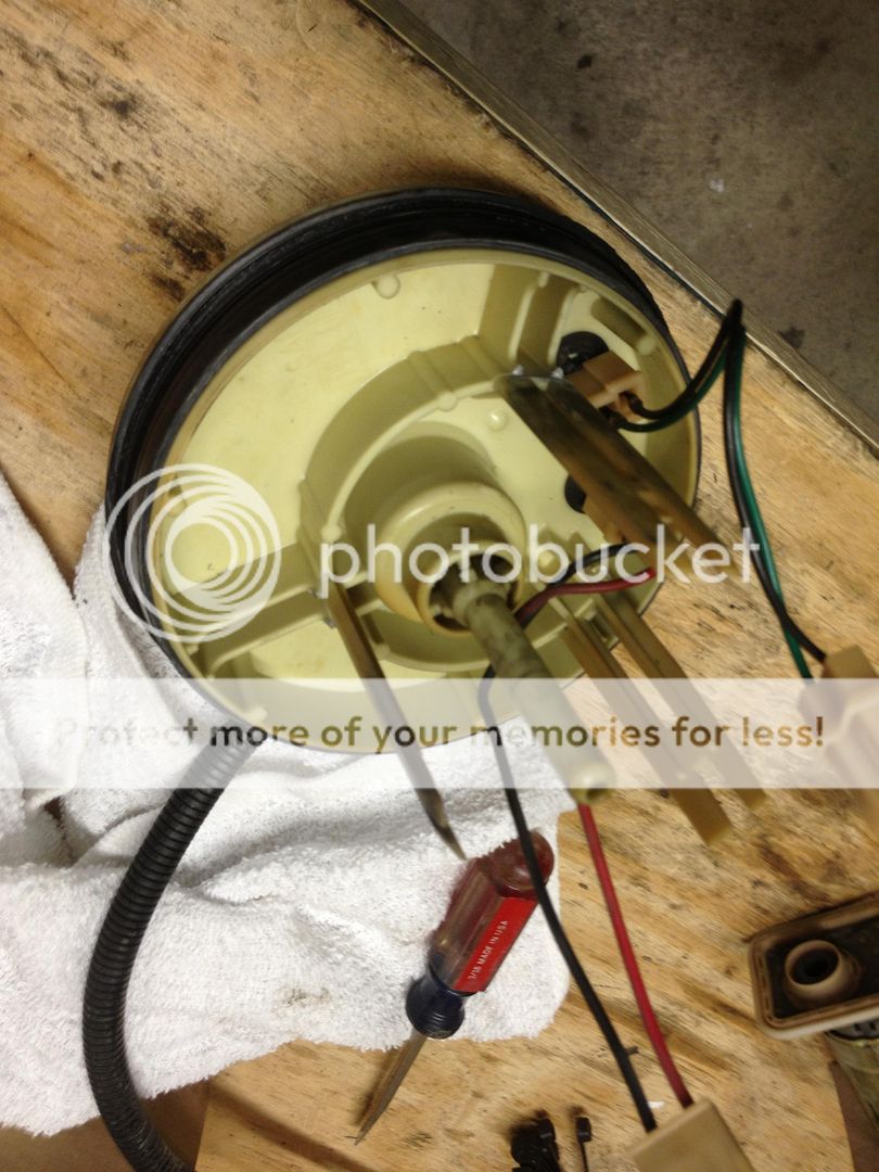

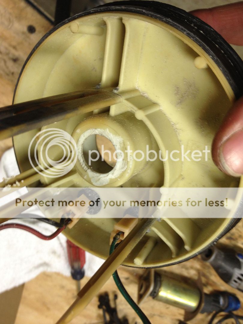

here you can see where the fuel pour out around the intake shaft
we are cutting the stock intake shaft off the housing
now something i can work with
i grabbed a random AN fitting to see what 'I had' to work with. looks promising to me. obviously im not going to use an 10-AN fitting LOL

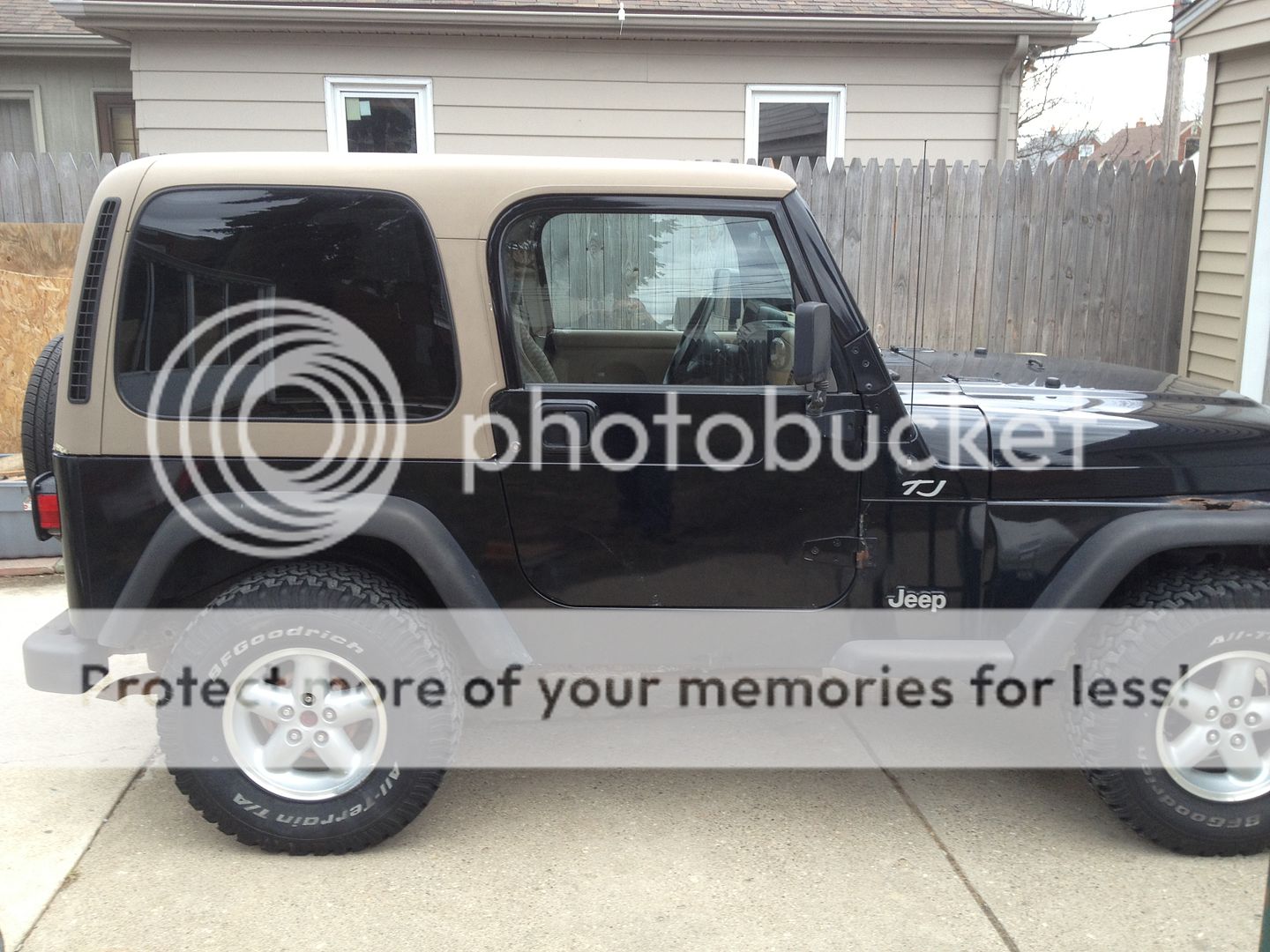

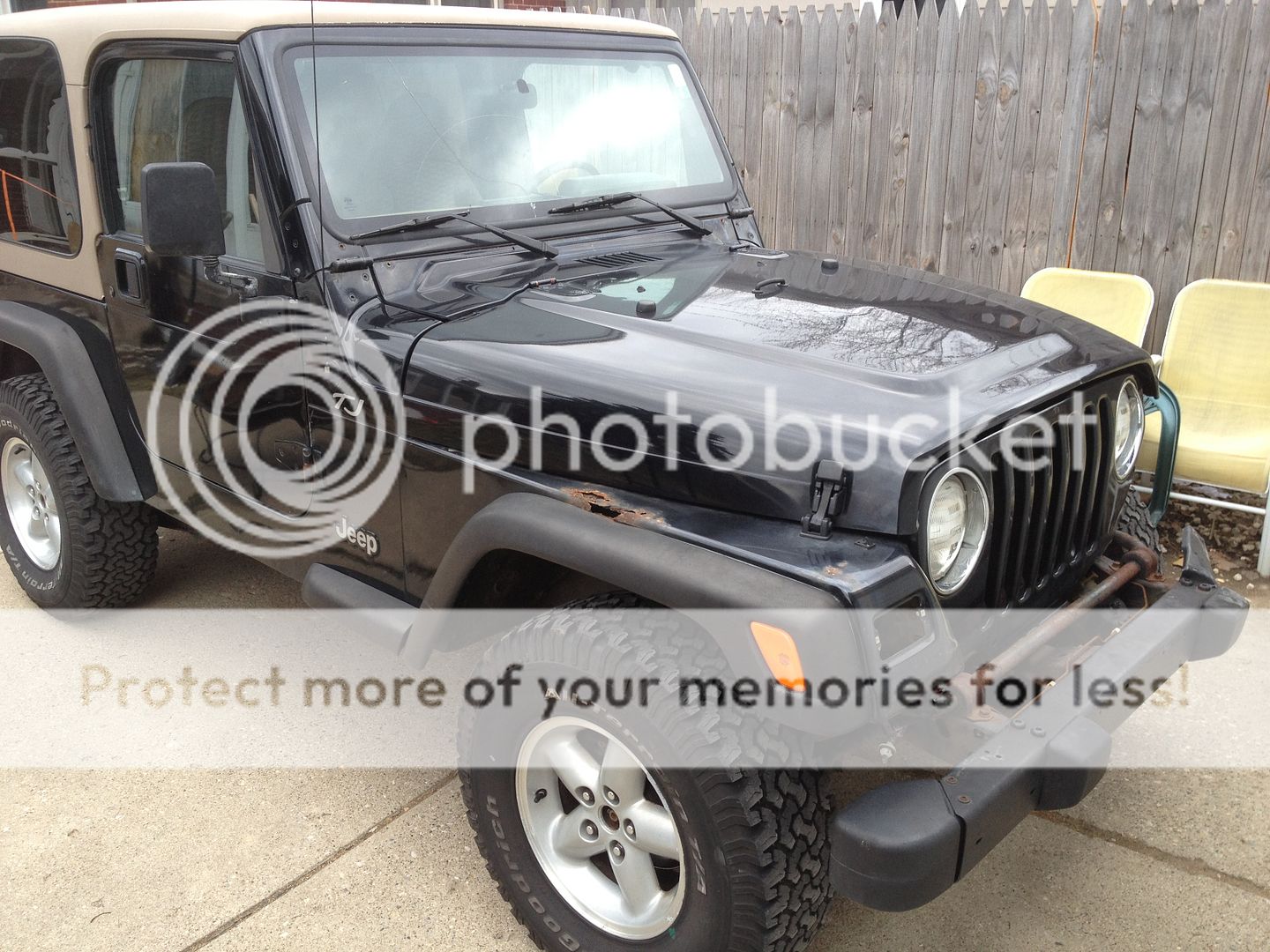

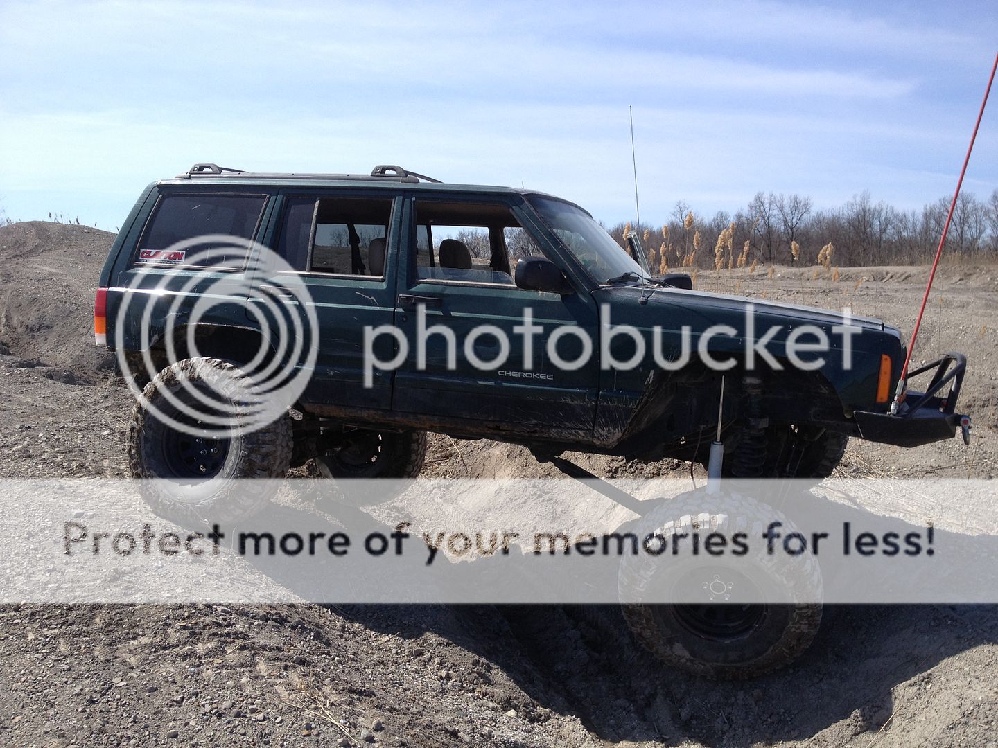

clint.. right on, I saw that little guy down there when I took it apart. i was actually thinking about changing the flow ports on the basket when I start messing with the new fittings.
heres the potential new candidate for the LS swap.. aka my practice jeep..lol. not sure eddies gonna get it or not just yet, so im moving forward with parts acquisition and development.
the bad
the inside

went out to the jeep parts yard today and got all the stuff to got to an auto, replacement flare, hood latches, grille support bars, pass floor patch panel, good stock gas tank skid, 40 fender mounting bolts, marker light housings, extended bump stops for the blue TJ and some other parts for brians jeep.

today was a play day
eddies Cherokee we just finished fixing and 'adding' to
found my next truck...
little playing... click on to play
