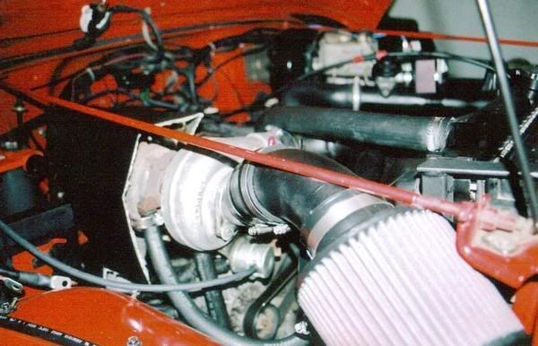

LOL,. I'll run a turbo over a supercharger. this is some of the stuff I custom build and put together.
The chevy is a street legal driver with around 1100HP.
