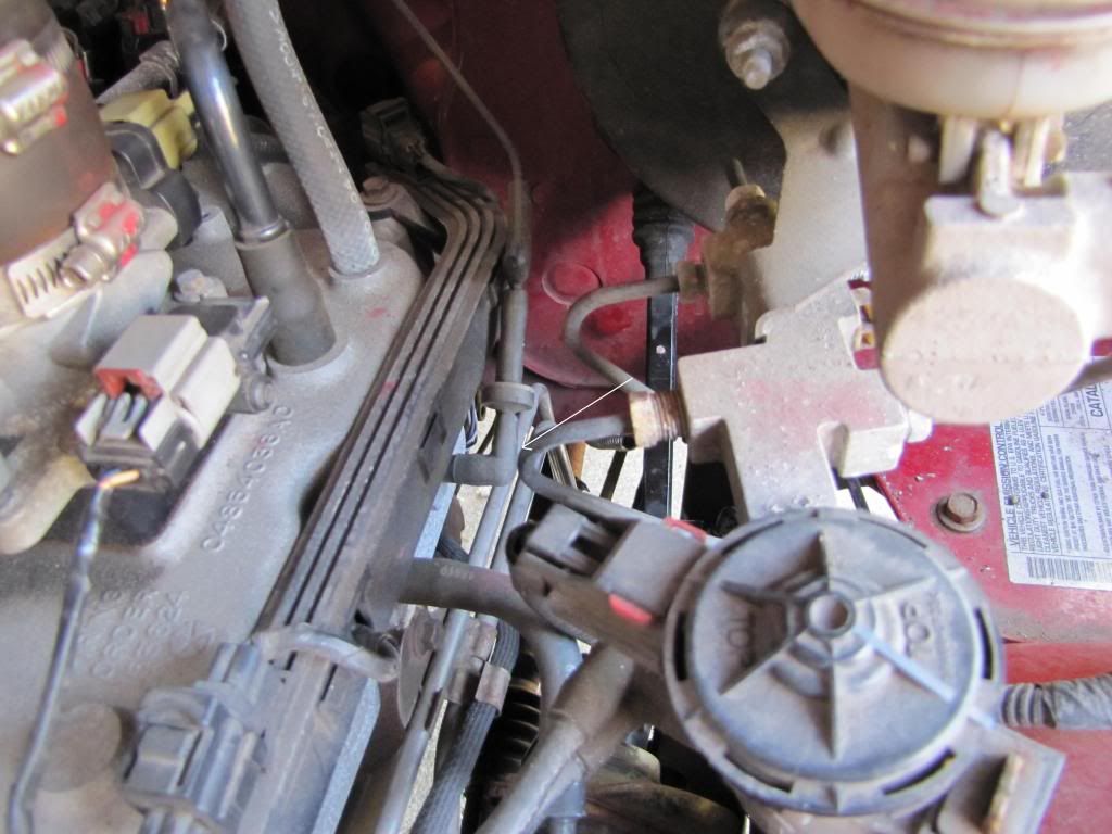

post #14 of 17 Old 09-21-2011, 05:07 AM
JPNinPA
Location: Dayton
Posts: 2,330
Does your heater fan vent selector work. Is it slow? This vac line is often the point of a vac leak.
Also spray around the block where the intake meets at each cylinder.
"Never look down on anyone unless your helping them up"- Jesse Jackson
JPNinPA is offline
post #15 of 17 Old 09-21-2011, 08:25 PM Thread Starter
Dabbill
Location: Robertsville
Posts: 374
I took off that line you have in the picture, my idle increased, put it back on and my idle went back to normal. So guessing that is not the leak. Engine was to hot to try and move stuff around to spray the intake. Lots of stuff in a small area lol.
